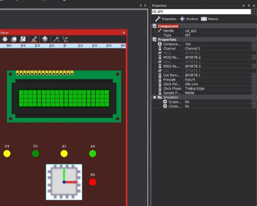

I have tried any possible combination of SPI component properties (clock polarity, clock phase, sample point) but the result is the same.
Could you check please if there is an error on my properties setting? Here is the SPI bus specification of SX1272 Thanks

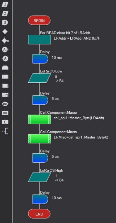

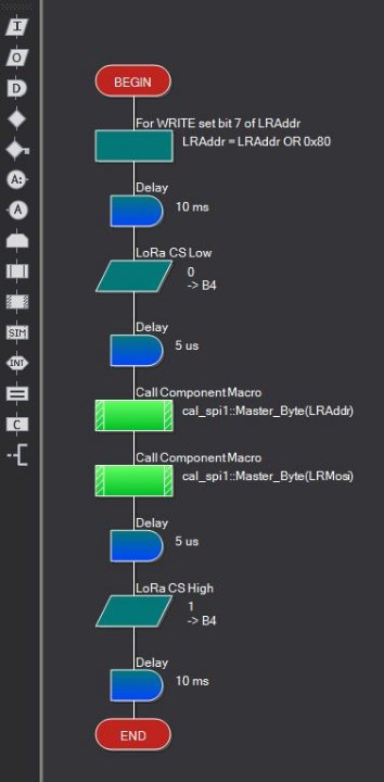

Here is the SPI Write macro
Here is the SPI Read macro
I should refer that, with the same SPI Read-Write macros I have success in the communication of the P16F18877 with an ATM90E32AS energy monitor IC connected to SPI Channel 1.
The Semtech SX1272 is connected to SPI channel 2 of P16F18877.
However, I haven't tried both SPI channels working simultaneously so far.
Having your review regarding the FC SPI component properties and the FC Read-Write macros, I could make later a question in RF-Solutions which is the provider of the LoRa module.

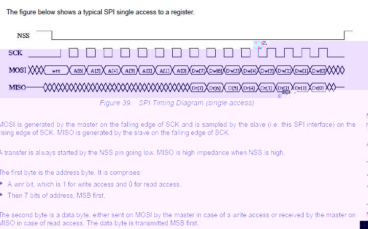

In the previous post, you could see on the FC pics the setup time from SS Enable (CS Low) to MOSI and MOSI to CS High that is 5μsec.
I think both are within the range of SX1272.

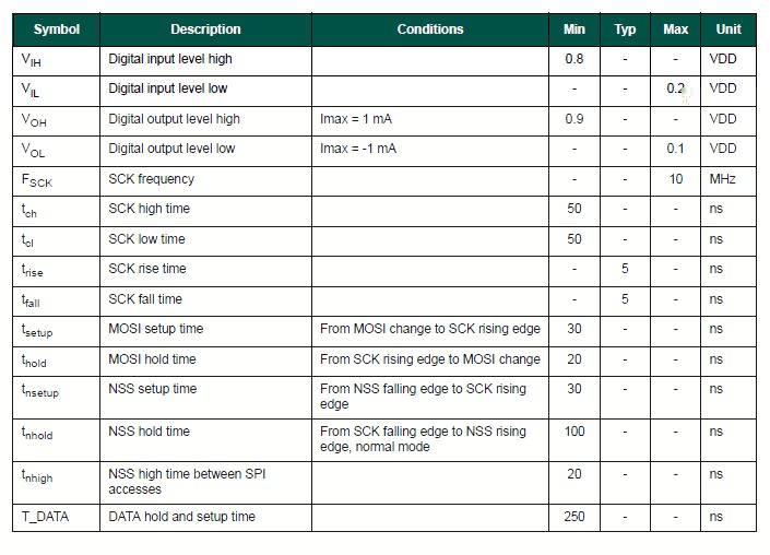

Here the SPI timing specification of SX1272: Thanks

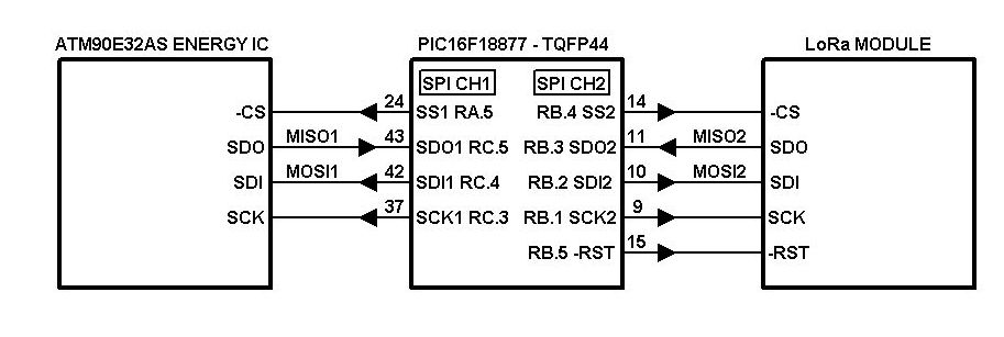

Here is a schematic of my hardware that could help you better? It would be precious for me a confirmation that the SPI Channel 2 is free of bugs within Flow Code. Then, something is going wrong with the LoRa module, and I could make a question to RF-Solutions.
By anyway, thank you so much for your care.
Best Regards FOTIS ANAGNOSTOU

I placed SPI components on both SPI channels and compiled the code so you could make a line by line comparison of the definitions in C.
Here the definitions of SPI CH1:
And here the definitions of SPI CH2
In my FC, the SPI CH1 (which is working flawlessly) is mapped as follows:
MISO_1: RC.5
MOSI_1: RC.4
SCK_1: RC.3
SS_1: RA.5
The SPI CH2 (which is not working) is mapped as follows:
MISO_2: RB.3
MOSI_2: RB.2
SCK_2: RB.1
SS_2: RB.4
Please note that in my hardware the micro used is a P16F18877 in TQFP44 package and its ports are allocated on different pins compared to PDIP40 package. Perhaps the problem arises from that?
Use :cal_spi1
:Variable declarations
:Macro function declarations
#define MX_SPI_SS_TRIS_1 tris
#define MX_SPI_MISO_PORT_1 portc
#define MX_SPI_SCK_TRIS_1 trisc
#define MX_SPI_SCK_PIN_1 (3)
#define MX_SPI_MOSI_TRIS_1 trisc
#define MX_SPI_BMODE_1 (2)
#define MX_SPI_MISO_TRIS_1 trisc
#define MX_SPI_MOSI_PIN_1 (4)
#define MX_SPI_MISO_PIN_1 (5)
#define MX_SPI_SS_PIN_1 (0)
#define MX_SPI_PR_SCALE_1 (16)
#define MX_SPI_SS_PORT_1 port
#define MX_SPI_SCK_PORT_1 portc
#define MX_SPI_MOSI_PORT_1 portc
#define MX_SPI_CHANNEL_1 (1)
Use :cal_spi1
:Supplementary defines
#define MX_SPI_REF1
#define MX_SPI_REMAPPABLE_1 1
#define MX_SPI_MOSI_RPOR_1 RC4PPS
#define MX_SPI_MOSI_SDO_1 21
#define MX_SPI_CLK_RPOR_1 RC3PPS
#define MX_SPI_CLK_SCK_1 20
#define MX_SPI_MISO_RPINR_1 SSP1DATPPS
#define MX_SPI_MISO_RP_1 21Code: Select all
Use :cal_spi2
#define MX_SPI_SS_TRIS_2 tris
#define MX_SPI_MISO_PORT_2 portb
#define MX_SPI_SCK_TRIS_2 trisb
#define MX_SPI_SCK_PIN_2 (1)
#define MX_SPI_MOSI_TRIS_2 trisb
#define MX_SPI_BMODE_2 (2)
#define MX_SPI_MISO_TRIS_2 trisb
#define MX_SPI_MOSI_PIN_2 (2)
#define MX_SPI_MISO_PIN_2 (3)
#define MX_SPI_SS_PIN_2 (0)
#define MX_SPI_PR_SCALE_2 (16)
#define MX_SPI_SS_PORT_2 port
#define MX_SPI_SCK_PORT_2 portb
#define MX_SPI_MOSI_PORT_2 portb
#define MX_SPI_CHANNEL_2 (2)
Use :cal_spi2
#define MX_SPI_REF2
#define MX_SPI_REMAPPABLE_2 1
#define MX_SPI_MOSI_RPOR_2 RB2PPS
#define MX_SPI_MOSI_SDO_2 23
#define MX_SPI_CLK_RPOR_2 RB1PPS
#define MX_SPI_CLK_SCK_2 22
#define MX_SPI_MISO_RPINR_2 SSP2DATPPS
#define MX_SPI_MISO_RP_2 11MISO_1: RC.5
MOSI_1: RC.4
SCK_1: RC.3
SS_1: RA.5
MISO_2: RB.3
MOSI_2: RB.2
SCK_2: RB.1
SS_2: RB.4
Here the PIC16F18877 pin-port default mapping after reset:
PDIP40 pin TQFP44 pin
SCK_1(RC.3) 18 37
SDI_1 (RC.4) 23 42
SS_1 (RA.5) 7 24
SCK_2 (RB.1) 34 9
SDI_2 (RB.2) 35 10
SS_2 (RB.0) 33 8
SDO_1 (RC.5) 24 43 (Is not mapped by default, it is PPS remappable)
SDO_2 (RB.3) 36 11 (Is not mapped by default, it is PPS remappable)Thanks

Good morning
I found bug and in SPI CH1.
Just to remember that we talk for the P16F18877.
The CH1 is working flawlessly with the following component properties:
MOSI = RC.4
MISO = RC.5
SCK = RC.3
This is not the default mapping of CH1 after reset.
I exchanged the mapping of MOSI - MISO and now the CH1 present bug:
MOSI = RC.5
MISO = RC.4
SCK = RC.3
This is the default mapping after reset.
Then, I mapped the CH1 to the default pins of CH2:
MOSI = RB.3
MISO = RB.2
SCK = RB.1
It presents bug
Exchanging the MOSI - MISO mapping also presents bug:
MOSI = RB.2
MISO = RB.3
SCK = RB.1
I'm pretty sure that the remapping (PPS functionality of P16F18877) is incomplete and contains many bugs.
Could you take care of it, please?
I'm in waiting for the 4th day.
I have to debug a big FC LoRa TX-RX code!
