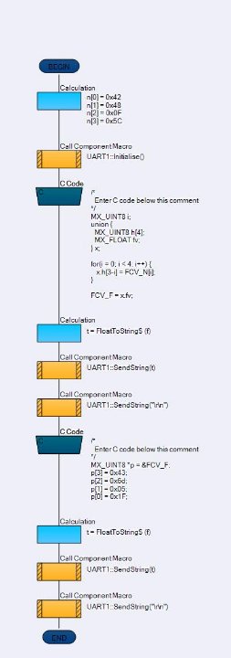

This works (on an Arduino at least)
Uses an array of 4 bytes 'n and a float f and a string t (meaningful names!?)
The C code puts the hex given into a float in reverse order (so f[3] = h[0]) and converts from hex to a float using a union...
Just output converted value to UART as a test... (In this case 50.014999)
(An alternative approach would be to take the address of the float as a pointer to byte and add the data using that?) - and the second C block shows one way to do this (with the values hardcoded here!) which just pushes the value directly into a FC variable - I would suggest creating a function taking an array of 4 hex digits and returning a float!
Note: You could use a loop with *p++ = FCV_N[3-i] or as in first block p[3-i] = FCV_N) as a more readable alternative in the second C block.

More usefully as a macro....

The computer memory is an 'array' of 8 bit 'cells' with an address for each (so for an Arduino - the address could be 0..2047 for it 2048 byte RAM)
A 'variable' in a program is actually the address of one or more bytes in memory (so for a float (32 bit) it would point to 4 bytes somewhere in the memory)
So - a float f (32 bit) is stored in memory at 4 consecutive locations which the program can read and write to to manipulate the value of 'f'
'f' might be '12' (the address - not the actual value of the variable) and would reference the memory at addresses 12,13,14,15) - when a program uses a variable - the MCU loads from this memory address into a register - performs some calculation on it - then stores it back...)
The '&' operator gets the address of a variable - and then we 'poke' (to use a basic term) or store the values we want into the memory cells - and we can just treat this address as a pointer to an array (we've specified a point to a byte (MX_UINT8) - so we are just writing a byte at a time - then it's just a matter of storing the values we want in the right order)
Then when our program accesses the variable it retrieves the values we stored - and treats them as a (in this case) floating point value..
The C code won't simulate unfortunately.
