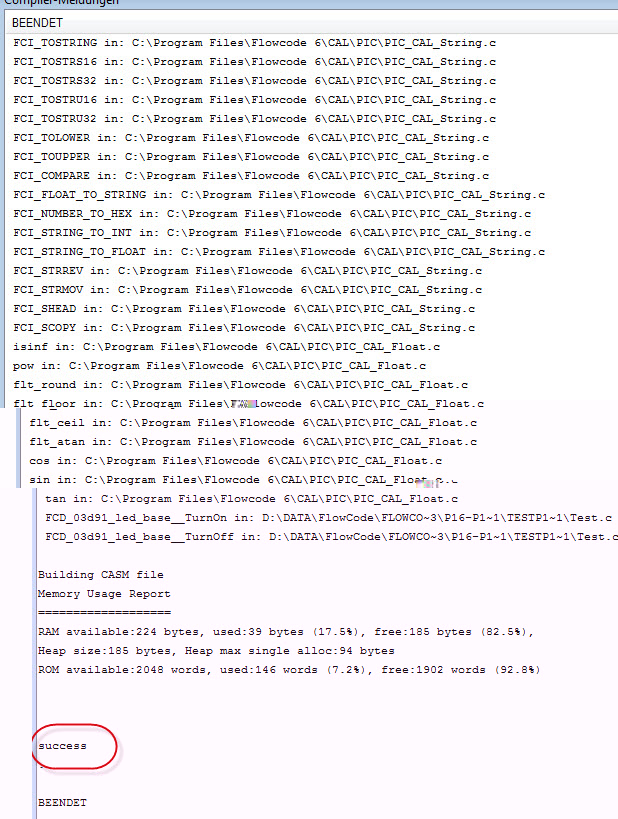

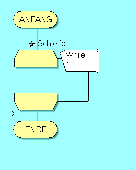

It does not compile with me for the P16F628 ,I removed all code except the while loop and error 1 is still reported

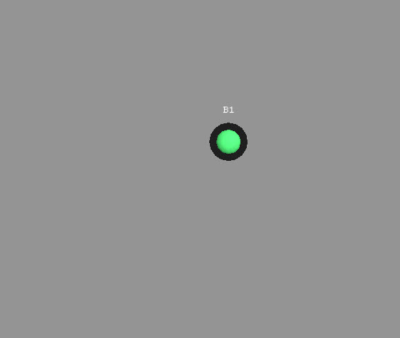

Please try to compile this project as it runs 100% with me
