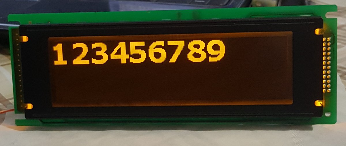

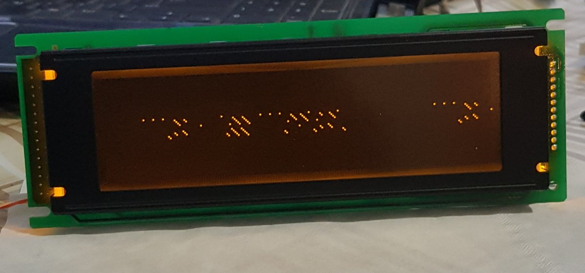

I have been struggling for a long time to use the GLCD based on the Toshiba T6963C chip ...
I asked for help including this forum in an older topic (a topic opened by a colleague).
I made a proper pcb to exclude any connection errors. I can't write anything readable on it with Flowcode 8.
Anyone managed to use the GLCD component (T6963C) in Flowcode 8? Is this component functional?
I asked a friend and he wrote me a simple test code in Jal to check the hw part and everything is OK.
If I put the hex compiled in Flowcode it only shows me garbage.
I don't know what else to do ...

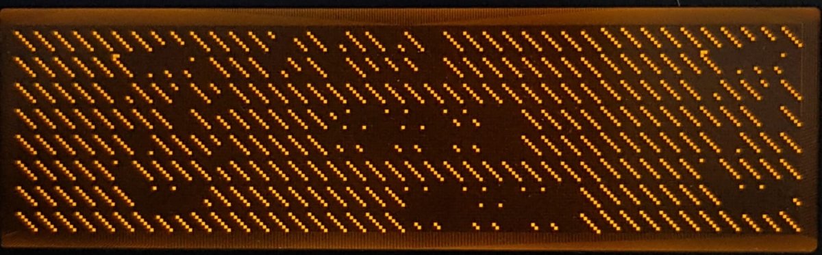

Today I got another GLCD also with T6963 and also 64x240 and the result is the same.
Interestingly, the image tends to appear twice, after the image is finished, the same image continues to start.
I attach the image from the laptop and the images displayed on both GLCD.
Image from Laptop:
Image on Amber GLCD:
Image on Green GLCD:
