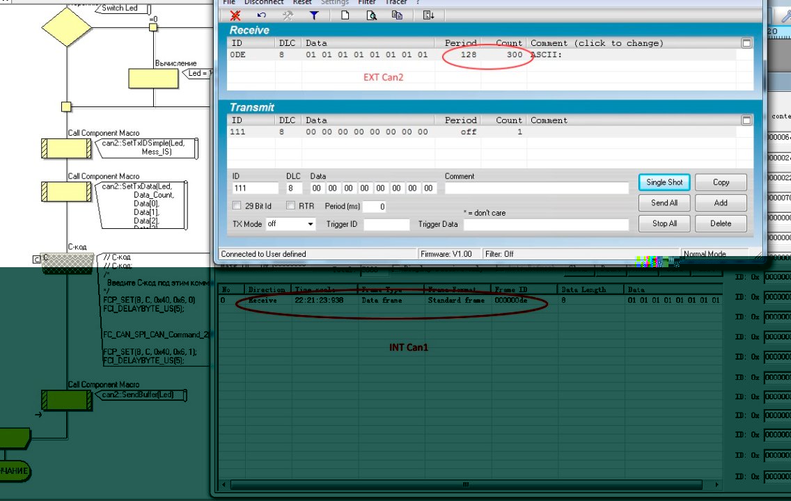

And one more strange moment:
If I use 3buffers at the same time variant I see singular sending on internal CAN1 channel with data from the flowchat for CAN2.
And if there is variant for 3 buffers (with my C) I see singular sending on internal CAN1 channel with data from his buffer TX2
But there is no any sending for CAN1 in flowchat! (I attached it a few posts before).

I removed the old CAN.fcpx and placed your to component directory.
Make new hex and... don't see any positive changes:
It steel sends 1 jf 10 frames and 1 from unused component (CAN1)

As I see I can't use ext.CAN and SPI together or I have to run init. for every component before every operation?
p.s. If I use SPI (FCD_06c41_SPI_Master1__SendChar(129);) I see almost 2 times more frames (546 from 3000).
Now I have checked some variants (spi, can2,can1) All of them have the same timing about 0,005 sec. So, I think the main problem - is a trying to send a frame from TX before it get clear (send previous). But why does my main program want so big delays?...

Barmaley_GMN
Posts: 59
Joined: Mon Aug 04, 2014 12:59 pm
Has thanked: 8 times
Been thanked: 4 times
Re: SPEED CAN-BUS inernal external
Post by Barmaley_GMN »
How can I check if TXB0CTRL.TXREQ MCP2551 is 0?
LeighM
Posts: 2178
Has thanked: 481 times
Been thanked: 699 times
Post by LeighM »
Your CheckTx0 looks OK to me.
Could you perhaps drop the return value (Free0) into the SetTxData (maybe after Free1) and see what is being returned?
Maybe do not mask the Status byte, just to see it's full value.
Barmaley_GMN
Posts: 59
I have to change macro CheckTX1 to
FCR_RETVAL = FC_CAN_SPI_CAN_Status_2(160);
switch (FCL_BUFFER)
   case 0: FCR_RETVAL = FCR_RETVAL;
LeighM
Posts: 2178
Post by LeighM »
Sorry, ignore my last post :)
I've just noticed that you set the value of Free1 with the CAN status byte in CheckTx0()
The last log text that you posted, is that with the "while Free0" code disabled?
If so, what happens when you enable that code?
Barmaley_GMN
Posts: 59
I've rebuilt scheme with 15f25K80 and will check

Barmaley_GMN
Posts: 59
I'm confused.
How does it work?
