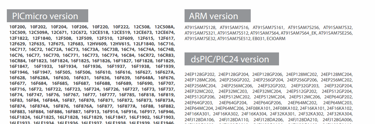

Does the picture below (from the release version of FC5 for PIC24 and dsPIC) answer the question?

Hello kersing
No! because: I have diverse probleme with the "big chips"
In the new literatur (news from elektor for dspicv5),there are these chips not in the chip-list.......
http://www.elektor.de/Uploads/Files/Pro ... ooklet.pdf
So I think it is important for me because I want use these cips!!!!!!!!!!
I learn intensive c with microc for have a comparison and have not these problems....code is running on my hardware ok.
The c code inside mplab with c30 compiler >>>> I have also probleme with the "big 24 and 33EP chips"

If the chips would not be supported you would not be able to select them (imho). However, there might be issues with the chips that need resolving.
It is not clear to me what you want to tell us with the screen shot. Perhaps you could clarify?
