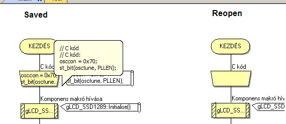

Was very good.
I have found a mistake.
The program has a "C" program:
When I left the project, and there is not I open the code "C".
Just a blank "C code" flowchart.
Making a demo program and video recorders, the square is drawn over a lack of size heel.
Was very good.
osccon = 0x70;
st_bit(osctune, PLLEN);Just a blank "C code" flowchart.
