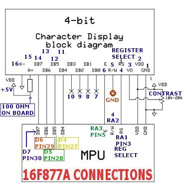

Hello all,
I am doing this keyboard reading example in "intro to micros".
My program is running as a simulation, but not on my QL200 development board.
I have been able to run all examples in the course so far, with a few modifications to the coding of ports.
This one however is not running on the board, so attached is the QL200 schematic, and my .FCF
I can see (via the data line LED'S) the micro is managing to scan the keys to a point, but then C0,C1, & C2 stop toggling, and nothing ever displays on the LCD at all.
I have used Port C for the keyboard, as that is how the DEV board is wired.
Any help wold be appreciated.
Thank you,
Jeff
Addendum:
I am using a PIC16F877A PROCESSOR!

I found that I was seeing no display without putting in a delay after the print command, as the display is so slow to react.
Also, i found the port lines were not being pulled up hard enough, despite the on board 10K Ohm pullup SIP for port C.
This was giving me erratic results after I put the print delay in. I put another set of pullup resistors in parallel, and the numbers became consistent.
So thanks for your suggestions!
