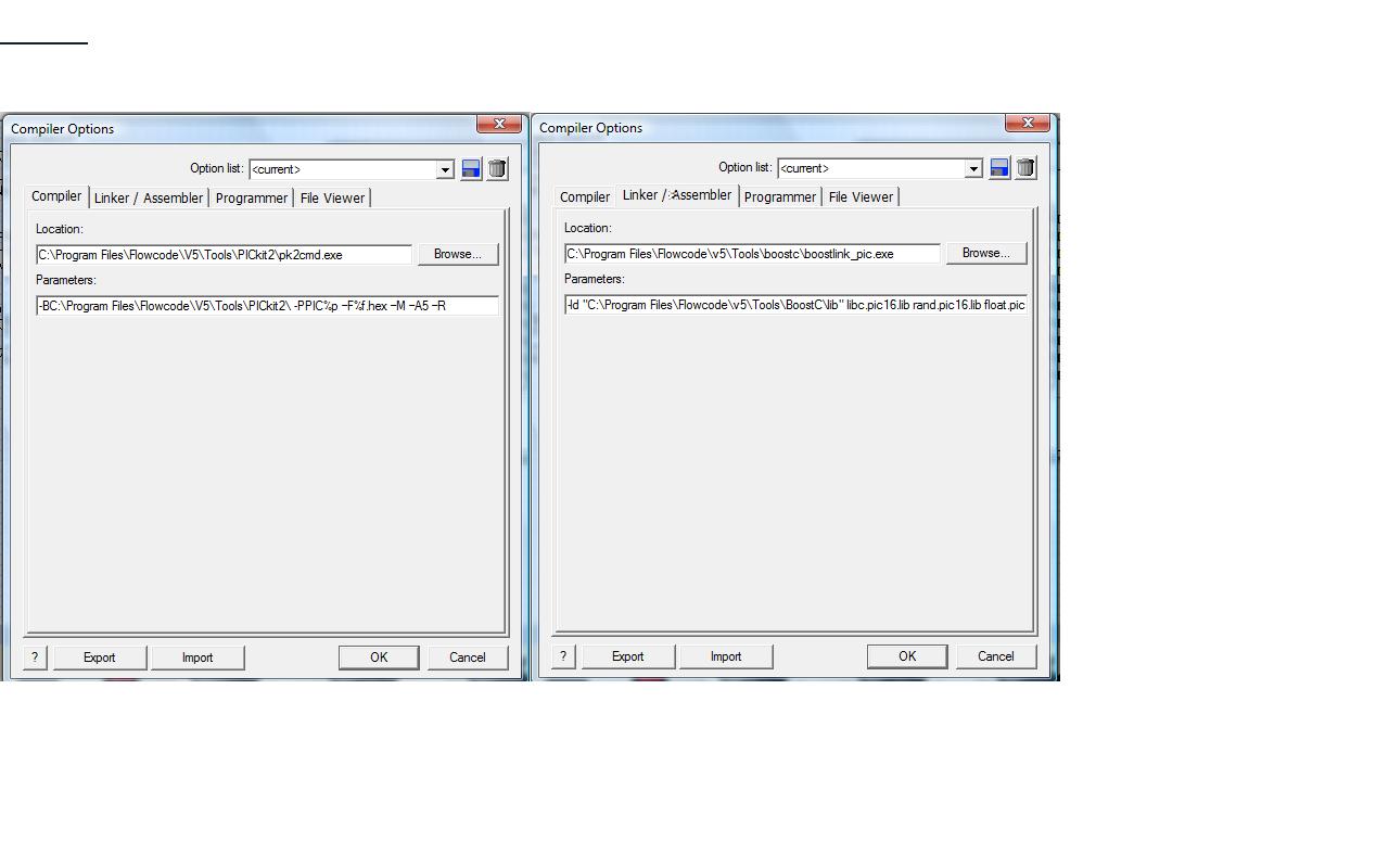

Hello everybody, could somebody please tell me why I cant convert to hex. I've attached the screen grab of my settings and the eerror.
Do these settings change from program to program? I tried using the same settingsd the last time I programmed a 16F690 PIC but must have made an error along the line.
Have also attached the program. Thanks so much for your help - John

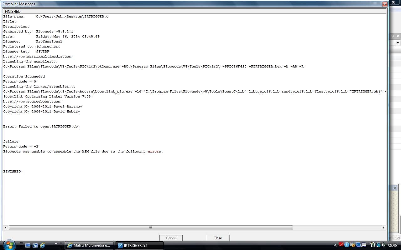

Re: Program Wont Compile to HEX
If you read the errors carefully you will notice the error is generated by the linker, not the programmer. I suspect the spaces in your filename are the cause of the error. Try saving the Flowcode file without spaces in the name.

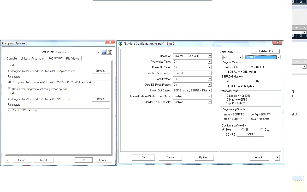

Thanks kersing, I tried that but the error was still the same.
In the hope I have made things easier for you guys, I have attached 2 files with screen grabs of my settings. Maybe I screwed something up here.
Appreciate your help,thanks again-John
tried with: watch dog: off
brown out detect : BOD disabilited and SBOREN disabilited
internal external switch over mode : disabilited
montitor clock fail- safe : disabilited
Electron67
Electron67
Thanks electron67, tried all that but the error report is still the same.
I have done a screen grab of it as this will be better than me trying to explain it.
Any help out there will be appreciated. Thanks a lot........John

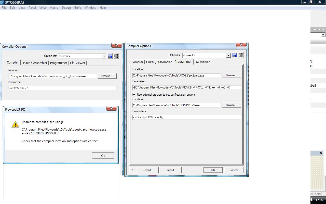

Have a check in Compiler options/Compiler if the parameters are
For location:
C:\Program Files (x86)\Flowcode\v5\Tools\boostc\boostc_pic18_flowcode.exe
For parameters :
-v -t PIC%p "%f.c"
I think you set the "Programmer" params of PICkit in the Compilers params
For location:
For parameters :
-v -t PIC%p "%f.c"

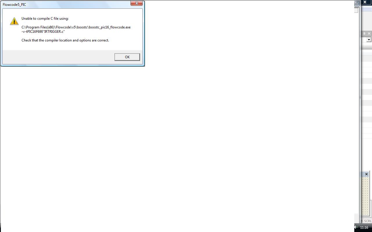

Thanks for the reply crenwick, but it seems to have got worse as now it wont compile to c either!!!!
Thanks anyway......John
Hi John,
It looks like you are missing spaces in both the location and parameters. Also, are you using 64 bit windows? If not remove " (x86)" from the location.
Jac
