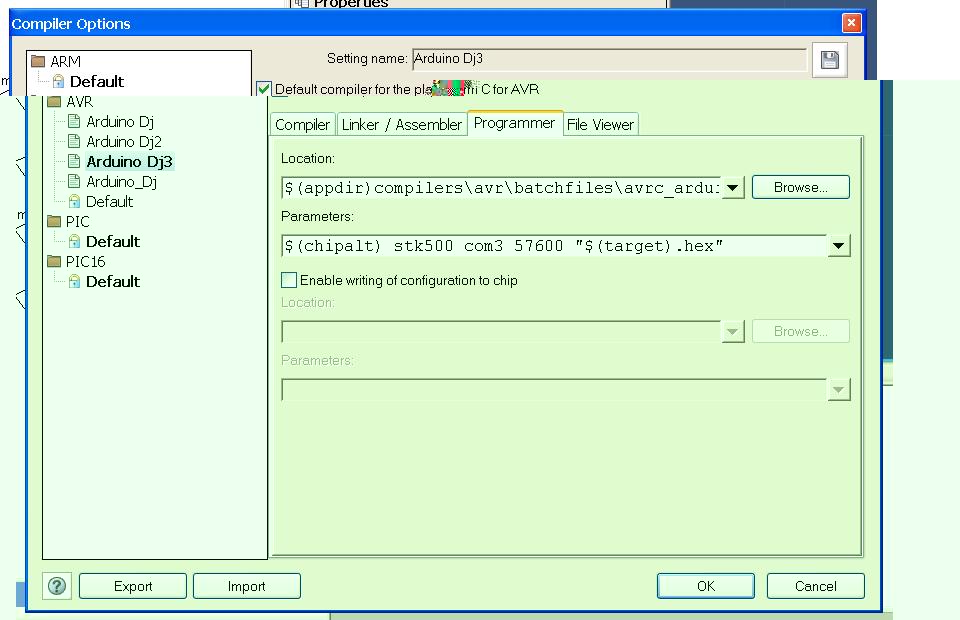

Arduino duemilanve problem
Re: Arduino duemilanve problem
Please can you attach your Flowcode program .fcfx file and I will have a look and see if I can spot what's causing the problem.
Thank you so much. Here are also screenshots of setting files.
With best regards,
Djordje
With best regards,
Djordje
Your output is on pin7 you need d13 which is pin(on chip) 19 or pb5 change it on the led properies
Dazz
Dazz
Hi Duzz,
THANK YOU so much. I have mistaken Pin 13 with Digital 13 and overlooked it million times. Thank you. You were mos kind. All the best to you.
Best regards,
Djordje
Best regards,
Djordje
Glad it's working, dont worry about the wrong pins we have all done it
