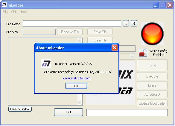

Thanks, Martin, for your reponse.
Excuse-me if I don't speek english very well. I'm french !!!
Yes, I have downloaded drivers from your website :
EB006 (v9) USB Driver and mLoader Programming Software
I have done all it's describe in joined file.
mLoader seem to work correctly : when I connect EB006V9 to a USB port, board is detected.
When I click on Autodetect button, mLoader recognised the microcontroller 16F877A I have monted on the board.
When I select a .hex file generated on Flowcode V4, and when I click on Send button, file is transfered in microcontroller, the LED Program flickers on board... But after the transfer, the program does not run...
I wonder whether the files that I have downloaded are compatible with Flowcode V4.
Thanks for your help.
Joel

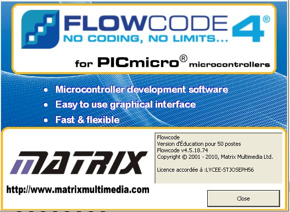

Thanks, Martin,
we have Flowcode V4 for PICmicro : view joined file
It's a Flowcode Educational Version for 50 postes.
When we buy it, it was Flowcode V4.3
For testing Flowcode with mLoader, and viewing configuration settings, I can do it tomorrow, at my school.
I have done all is detailed in http://www.flowcode.co.uk/faq/index.php? ... artlang=en
I have load mLoader v.3.2.2.6 and copy the files in a mLoaderPIC folder :
Location: C:\Program Files (x86)\Matrix Multimedia\Flowcode V4\Tools\mLoaderPIC\mLoader.exe
Parameters: -chip %p "%f.hex"
I can give you tomorrow screen printings.
Goodbye, and thanks very much for all your help.

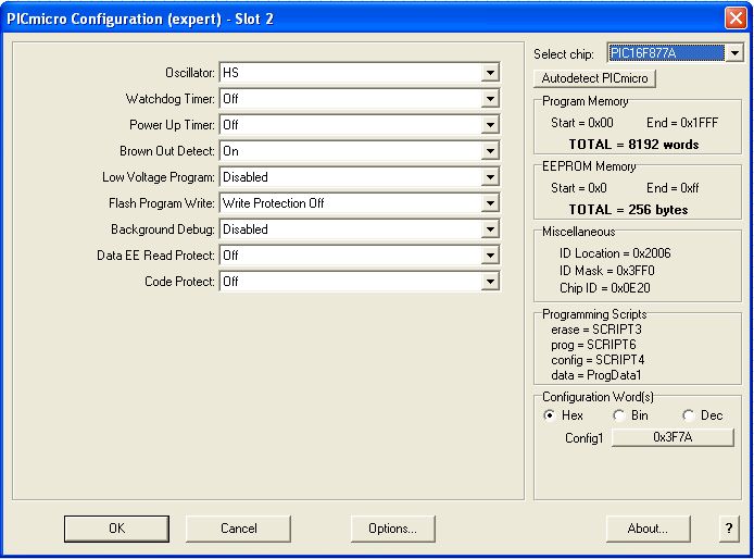

- Posts: 9521
- Has thanked: 2585 times
- Been thanked: 3815 times
Re: Problems with new EB006V9 with Flowcode V4 on Windows XP
Hi Joel,
Problem is with your configuration settings i.e they have not been set.
That's why your program is not running at all.
For example watchdog timer is enabled by default so your program is restarting every 18ms!
Flowcode V5 and V6 has the 16F877a preconfigured, Hence program would work
Flowcode V4 does not!
First select Chip, configure.
Make sure you have not got 'Use simple config screen' enabled.
If it is then you will see: Just select 'Switch To Expert Config Screen'
Select Options then un-select 'Use simple config screen'
So now you should have: Just select correct configuration settings like this: Finally select View, project options to sect correct clock speed.
Now send to chip.
If you can't see any of the above, then maybe you can see: If you do then you just select Chip, compiler options.
Select 'Use external program to set configuration settings'
Now send to chip.

Hi, Martin,
whaoooo !!! That's all right !!!
My programs did not go because Watchdog Timer was enabled.
I have just configure PIC such as you tell me to do.
I don't know how to thank you for your assistance : thanks to your advices, you allowed me to solve this problem of communication.
Thank you thousand times.
Well cordially, Martin.
Joël
Joël
- PICmicro Configuration (expert).jpg (66.22 KiB) Viewed 44541 times
