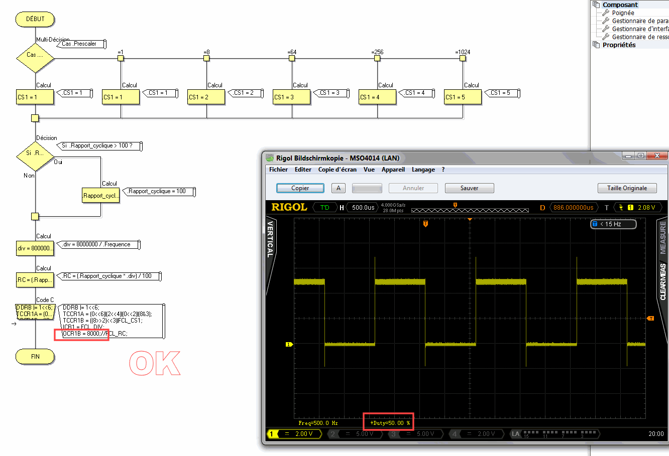

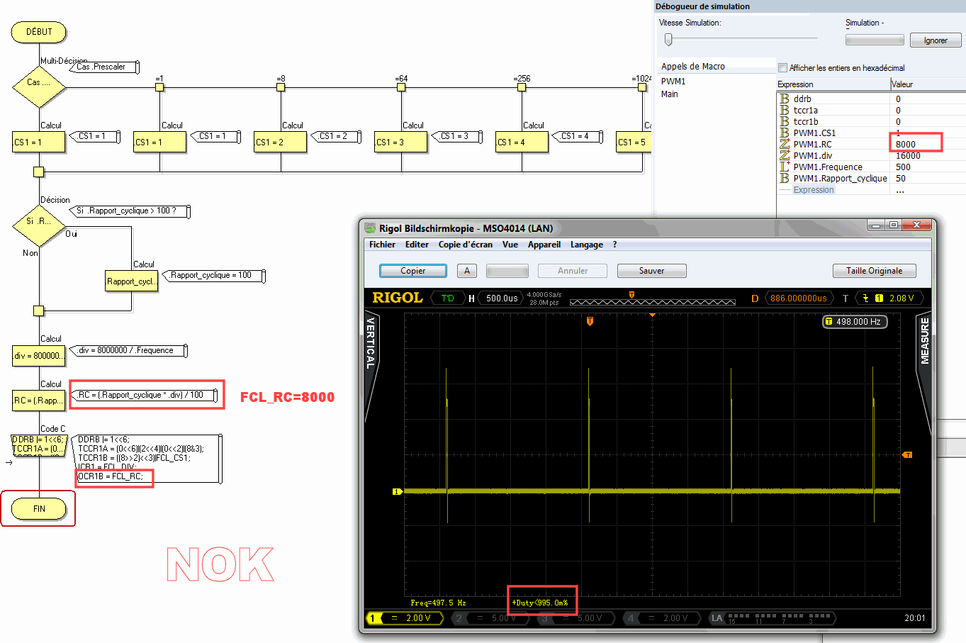

I made a PWM function that works. :mrgreen:
But there is a bug that I do not understand ...
Exemple :
MX_UINT8 FCL_CS1 = (0x0);
MX_UINT16 FCL_RC = (0x0);
MX_UINT16 FCL_DIV = (0x0);
.div = 16000
.RC = (.Rapport_cyclique * .div) / 100
.RC = 8000
OCR1B = FCL_RC; Wrong (the real value is about 500 max)) :?: :?: :?: :?:
If I put the value directly
OCR1B = 8000; is OK
(49.98 KiB) Downloaded 2524 times
(59.33 KiB) Downloaded 2524 times
Flowcode V6.1.2.0(11 05 2015)
kersing
Posts: 2045
Location: Netherlands
Has thanked: 553 times
Been thanked: 1081 times
Re: PWM Arduino MEGA
Post by kersing »
Looking at the information in your message:
That 16 bit variable can hold a value of 0 to 65535.
The formula:
.div = 16000
And in your debug window:
.Rapport_cyclique = 50
This results in .RC = (50 * 16000) / 100, which means the controller will first calculate 50 * 16000 = 800000. This is very much > 65535 so the result will become 800000 % 65536 = 13568 (only the remainder is kept, the overflow is discarded), which will be divided by 100, results in .RC = 135. You need to use either a MX_UINT32 (long) for .RC or restructure the calculation to make sure the (intermediate) result does not exceed the maximum value of your data type.

kersing
Posts: 2045
Post by kersing »
Change .div to a long as well.
The formula:
.div = 8000000 / .Frequence
Has the same problem with .div being an 16 bit (unsigned) integer.
― C.S. Lewis
cubitus54
Flowcode v5 User
Posts: 110
Joined: Wed Jun 19, 2013 7:18 am
Has thanked: 7 times
Been thanked: 32 times
Post by cubitus54 »
sorry
But I think there is no problem ...
What matters here is the result variable div, the result of the operation will not exceed 16 bits.
kersing
Posts: 2045
Post by kersing »
Try it to make sure you are right.
Or take a look at the generated assembler code to make sure that is not a problem. I think you will find the compiler generates a sequence where it loads the (too large) value in a 16 bit register and perform the division next. (Another solution could be to use 8000000l in the formula to force the compiler to use 32 bit while performing the calculation.)
― C.S. Lewis
cubitus54
Flowcode v5 User
Posts: 110
Post by cubitus54 »
OK. Sorry! You were right: oops:: roll:
To make this work we had put in the 32-bit variable .div
