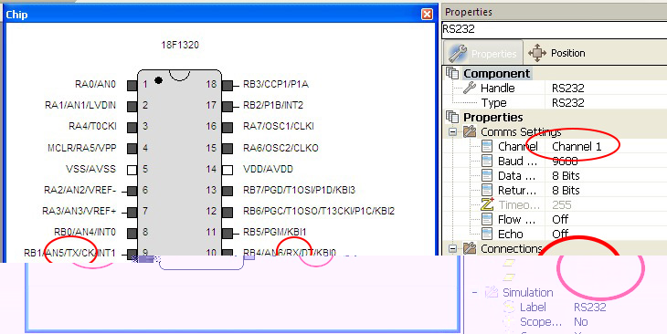

Hello!
Flowcode show wrong pins, but the HW uses the correct ones.
Sending 0 (zero) via RS232, the information not shown in the console.

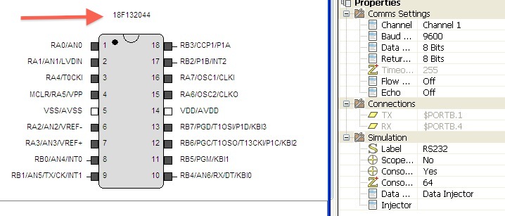

Ive attached an fcdx for that chip, rename the one in your fcd folder and paste the attached one in, i cant test it as i don't have that chip on hand.
Can you then post back here if it's ok
Dazz

The properties window is ok, only the chip name is too long. The console problem must be in the Flowcode, i think.

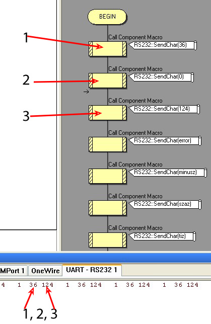

Bachman wrote:Sending 0 (zero) via RS232, the information not shown in the console.
When you use SendChar you need to look on the ASCII Table for the char being sent e.g 1 then look at the Dec number and send that value.
In the case of 1 you need to
SendChar(49)
If you want to send 0 then you use
SendChar(48)
(36.1 KiB) Downloaded 3295 times
An easier way to send a number is to send it as a string e.g SendString "0"
If you want to send a variable value e.g if VariableValue = 128
Then you could create a string then convert variable to a string then send the string:
(31.81 KiB) Downloaded 3295 times

Yes, it's a solution for the bug. If i convert the numbers into ASCII, i need extra steps on the RX side to convert it back to numbers. Sending zero via UART works fine in the HW, the bug "visible" only in the simulation.

Sorry about the name i used it for checking and forgot to remove the extra numbers (doh).
I have corrected and reattached to this post
Dazz

Bachman wrote:Yes, it's a solution for the bug. If i convert the numbers into ASCII, i need extra steps on the RX side to convert it back to numbers. Sending zero via UART works fine in the HW, the bug "visible" only in the simulation.
You don't need the extra steps to just send a 0.
Either sendChar(48)
or
SendString"0"
If you use SendChar(0) then that's a null character, not a 0.
So its just the termination of the string
The extra steps are only If sending a byte variable.
This is why i send 0, not "0".
