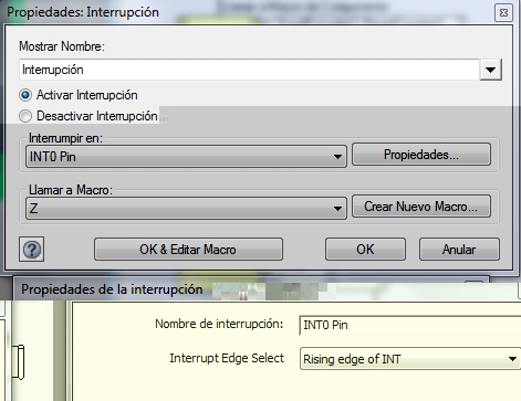

After many hours of study, I have seen how to do interruption in rb0 with flank of raise and flank of descent, yes we can in flowcode, I have used it to detect the step for z of the encoder, I leave here capture of screen for if someone needs some day...
