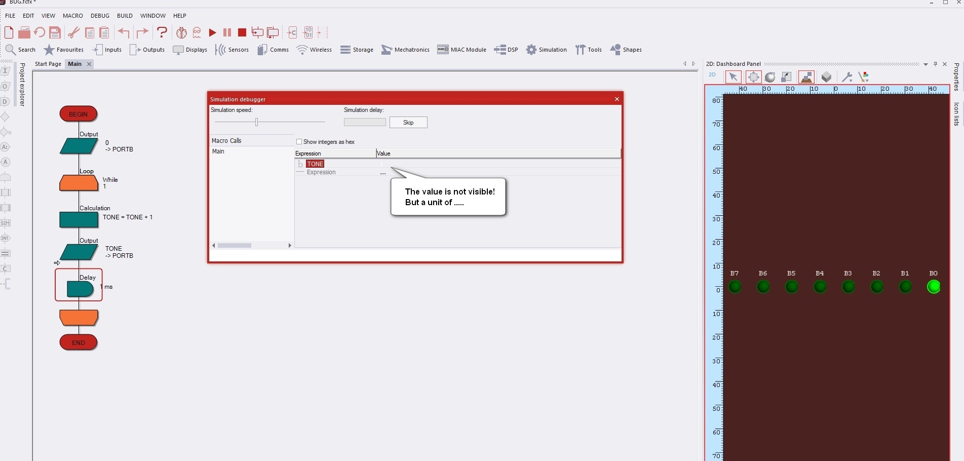

Bit variable behaves as a byte....
- I declare a variable of 1 bit
- 0 Перем.jpg (100.88 KiB) Viewed 17954 times
- Flowcode showed a 1 bit

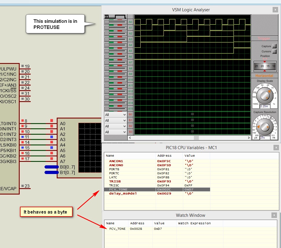

- Proteus showed a byte
- (221.66 KiB) Downloaded 815 times

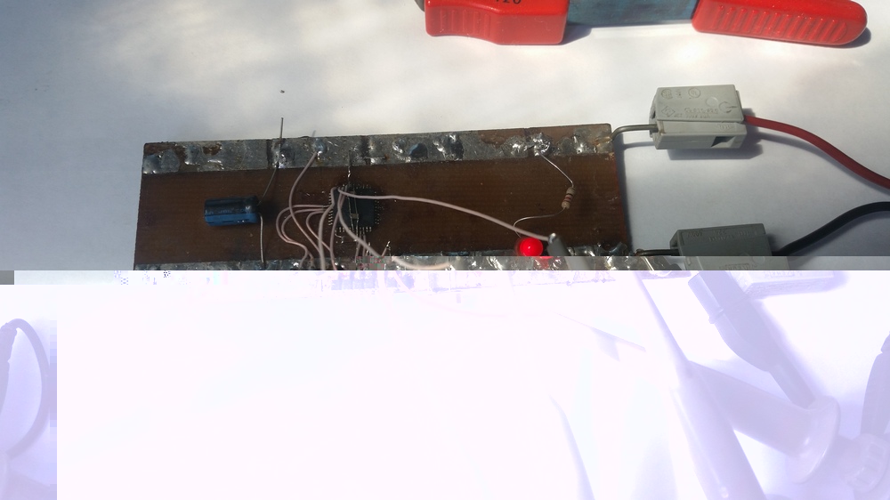

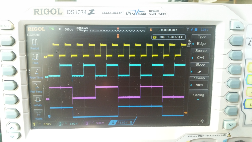

I did this device.
The real variable - BYTE !!!

- The device itself
- 3 Плата.jpg (160.23 KiB) Viewed 17954 times
- Oscilloscope
- 4 Осцил.jpg (181.84 KiB) Viewed 17954 times
