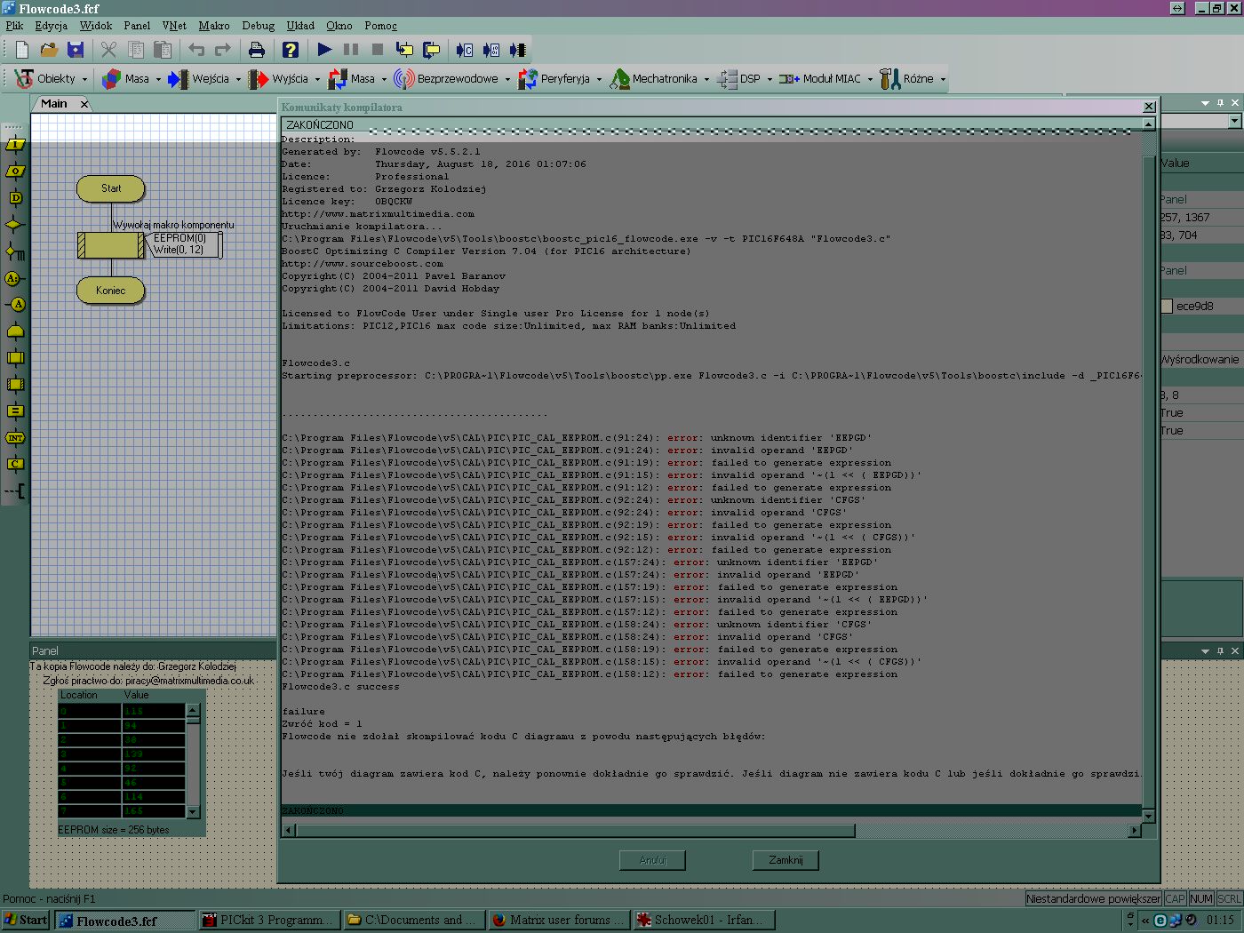

Hello
When compiling the program appears compile error associated with the use of the internal EEPROM in a PIC16F648A. This error occurs only for that uP, if you change it to PIC16F628A does not cause the appearance of this error.
Can it go.
Natalie

Hi Natalie,
For an unofficial fix:
Can you Replace 16F648A.fcd in C:\Program Files (x86)\Flowcode\v5\FCD (64 bit windows)
Or
C:\Program Files\Flowcode\v5\FCD\ (64 bit windows)
With the attached file.
Can you let me know if it works please.
