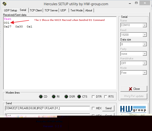

Re: I2C ACK
Hi LeighM
Here is a very simple Program i made now , when sending TEST to RS232 it
will Read the time registers from DS1307 RTC , but it first Sends the ACKS and NACK Received
on every Byte Transmitted .
The DS1307 Register byes dose not match the logic Analyzer cause it was taken at a different time .
But this should clearly show the BUG when sending D1 ( Read Command ) .
- 232test.jpg (133.54 KiB) Viewed 8565 times
