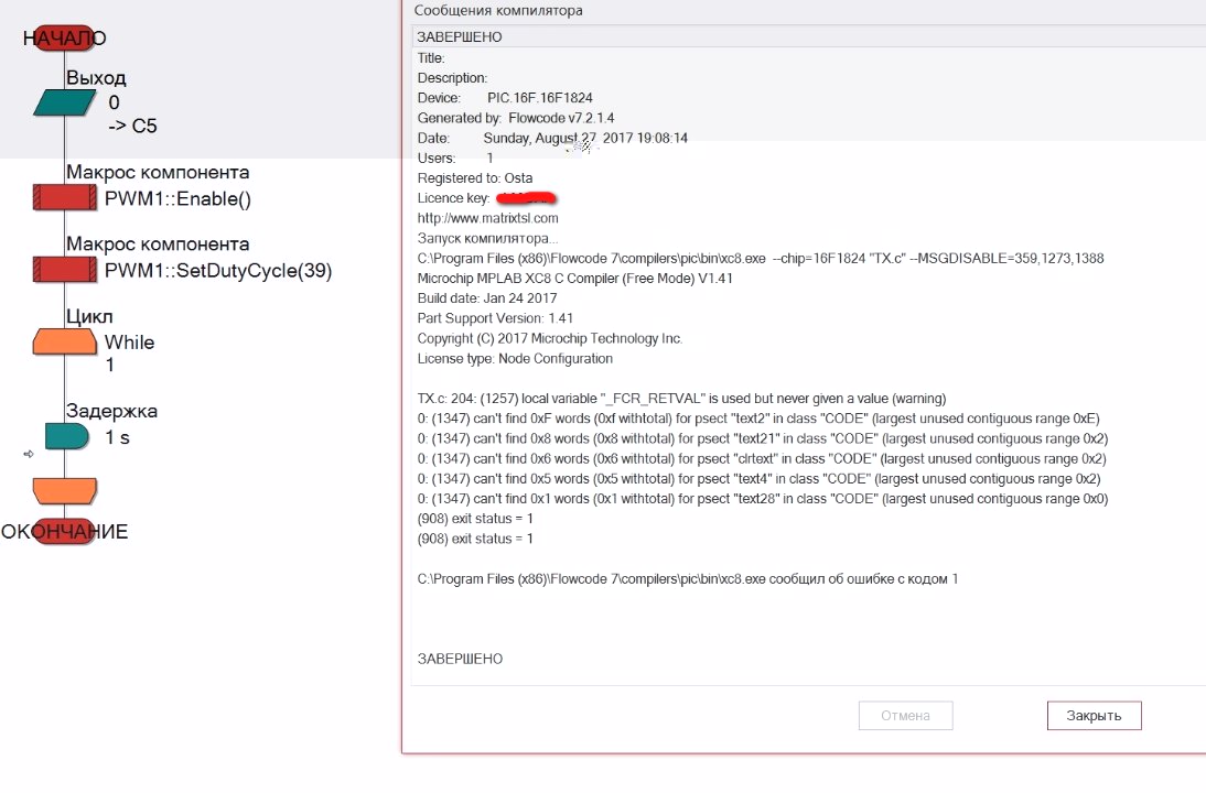

Does not compile
TX.fcfx
file
(8.04 KiB) Downloaded 521 times

Compiles for me ok:
Device:        PIC.16F.16F1824
Generated by:  Flowcode v7.2.1.4
Date:          Sunday, August 27, 2017 20:20:51
Users:         1
Registered to: Martin
Licence key:   BA48R5
http://www.flowcode.co.uk
Launching the compiler...
C:\Program Files (x86)\Flowcode 7\compilers\pic\bin\xc8.exe  --chip=16F1824 "TX.c" --MSGDISABLE=359,1273,1388
Microchip MPLAB XC8 C Compiler (Free Mode) V1.41
Build date: Jan 24 2017
Part Support Version: 1.41
Copyright (C) 2017 Microchip Technology Inc.
License type: Node Configuration
TX.c: 191: (1257) local variable "_FCR_RETVAL" is used but never given a value (warning)
Memory Summary:
    Program space        used    BFh (   191) of  1000h words   (  4.7%)
    Data space           used    24h (    36) of   100h bytes   ( 14.1%)
    EEPROM space         used     0h (     0) of   100h bytes   (  0.0%)
    Data stack space     used     0h (     0) of    DBh bytes   (  0.0%)
    Configuration bits   used     2h (     2) of     2h words   (100.0%)
    ID Location space    used     0h (     0) of     4h bytes   (  0.0%)
You have compiled in FREE mode.
Using Omniscient Code Generation that is available in PRO mode,
you could have produced up to 60% smaller and 400% faster code.
See http://www.microchip.com/MPLABXCcompilers for more information.
C:\Program Files (x86)\Flowcode 7\tools\DoNothing\DoNothing.exe
FINISHED
As a complete guess, Perhaps it is something to do with language settings?
Have you tried changing to English and seeing it it will compile for you?

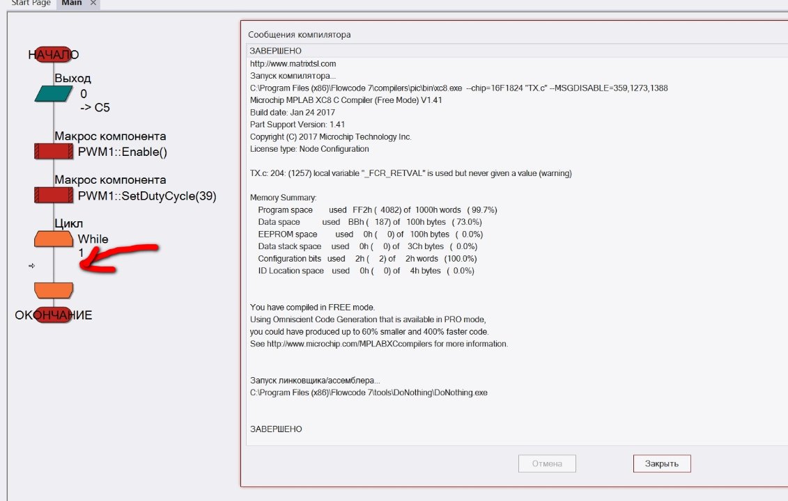

Take a look at how much program space your flowchart is using when you compiled it (99.7%) compared to when I compiled it (4.7%) and that was with the delay!
The Reason your first flowchart did not compile was due to using too much program space.
Not sure how such a small flowchart can use up lots of rom when you try to compile, but not when I compile it?

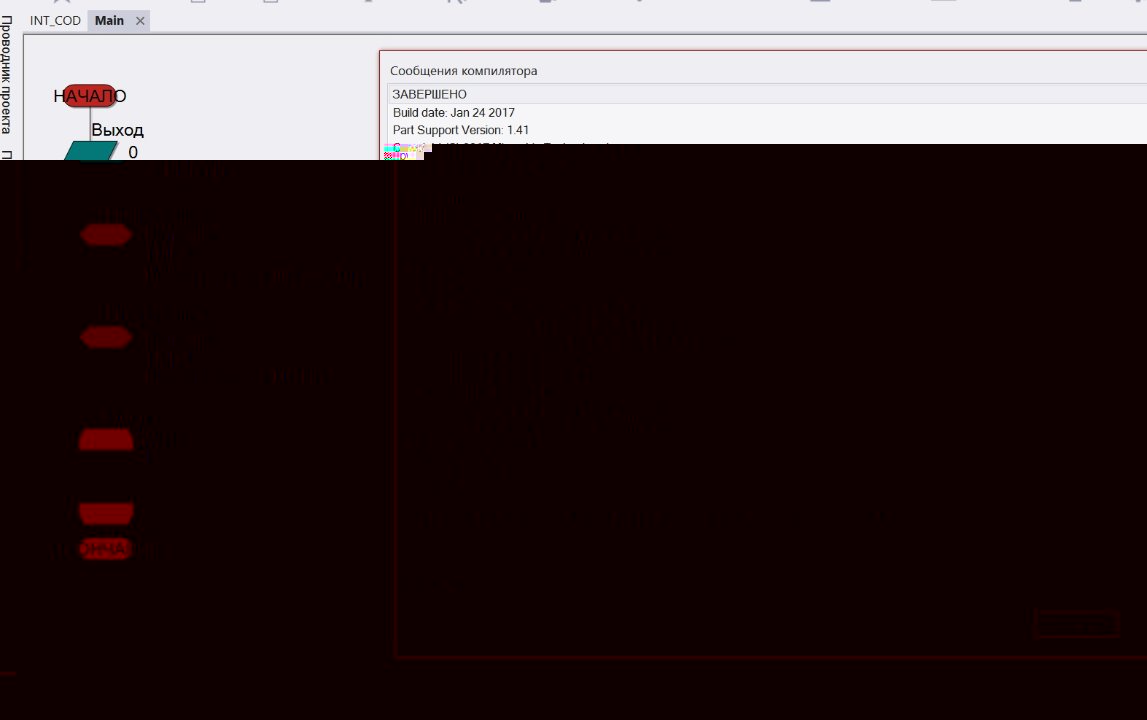

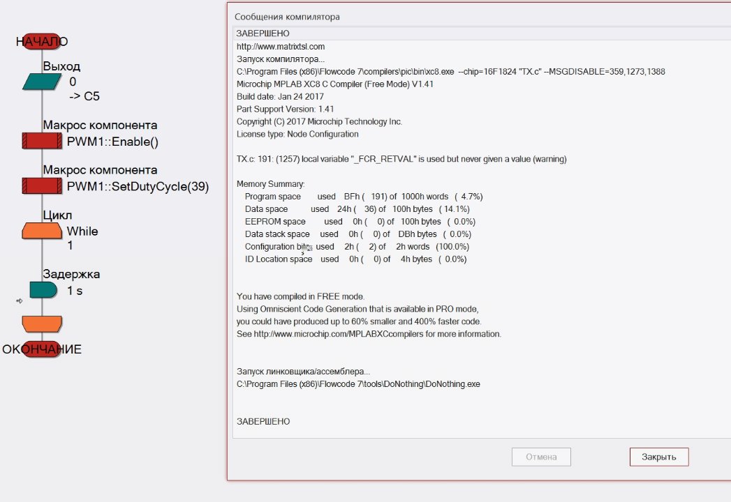

EDIT:
Rearranged the program.
And checked with every update.
That's what happened ....
And with it does not compile and there is a point on PWM
This compiles
This compiles
EDIT2:
It turns out that the last update introduces an error in the compiler.

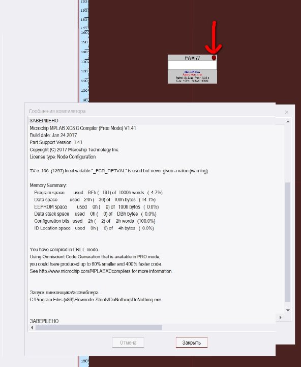

Updated PWM component attached,
to go into Flowcode7\components directory.
This should reduce the download code size
PWM.fcpx
(8.96 KiB) Downloaded 622 times
Osta
Posts: 159
Joined: Tue Jul 05, 2016 9:42 am
Been thanked: 13 times
Re: PIC16F1824 PWM
Post by Osta »
Thanks for the correction!
Yes, the code has become smaller.
But the simulation indicator remained.
LeighM
Posts: 2178
Has thanked: 481 times
Been thanked: 699 times
Re: PIC16F1824 PWM
Post by LeighM »
That is a new feature that indicates when the PWM is enabled.
Do you have a problem with it?
