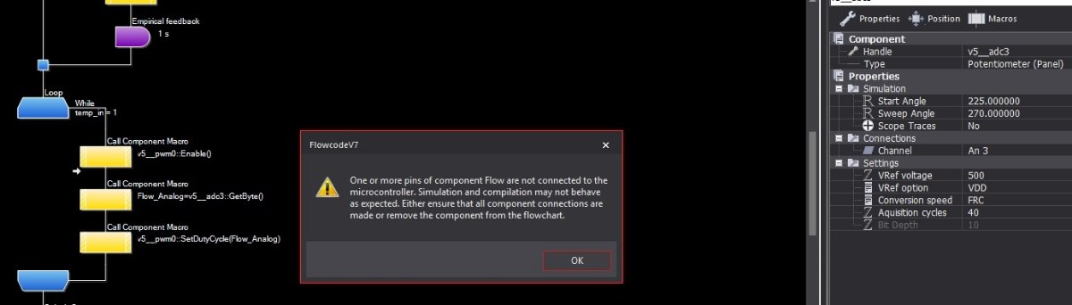

The error below comes up when compiling to hex. The program works fine, and the component pins ARE actually connected. Is there an explanation for this?

Please post your flowchart... Debugging these errors is difficult without sufficient information and the flowchart contains a lot of information.
If I had to hazard a guess, you have more analog components added and one of them has unconnected pins.

Two channels were assigned to An3 (one was flow - which was mine) one of those channels automatically has some "pot_chicken_Pie" name which was confusing. I had added a different one (flow), and subsequently removed pot_chicken_whatsit due to your suggestion. Problem solved.
