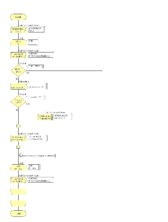

Re: need help
Good morning sir
I have try a lot to print the numbers on lcd 16 * 4 but each time i got bad results i couldn't control the digit in the exact
place help me how to print using lcd 16 * 4

Re: need help
Sorry unable tell from that.
Can't help without a flowchart.
Only if you want to keep it private then you pm it.
Re: need help
medelec35 wrote:Sorry unable tell from that.
hi
this is the flowchart
- Flowcode1 - Main.JPG (25.72 KiB) Viewed 22159 times
