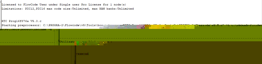

Since the last update of Windows 10 (version 1803), the compiler HEX no longer stops. He never ends.
I uninstalled, reinstalled the program, no changes

This is one of the first code I wrote several years ago. After 5 minutes, the compiler did not finish. I canceled manually

As well as windows 10 64bits. Same version Flowcode (30.01.2013). Yesterday everything worked very well and after the update of windows, nothing.
