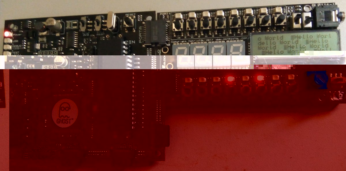

After updating the FC7 LCD component with the new LCD.fcpx, neither BL0080 works right now.
Please note that I had no problem with it and P16F18877 so far.
See how it prints
Here my simple fcf to test LCD
LCDtest.fcfx
(10.56 KiB) Downloaded 537 times
Best Regards FOTIS ANAGNOSTOU
Re: BL0080 problem
Sorry for the problems. I've reverted the LCD component back to how it was originally and this has fixed the problem but causes the problem to re-appear on the ST-ARM.
Here is the original component file to allow you to switch back to get the PIC working again.
LCD.fcpx
(7.54 KiB) Downloaded 499 times
Re: BL0080 problem
New universal fix posted here.
viewtopic.php?f=2&t=20040&start=25#p88651
