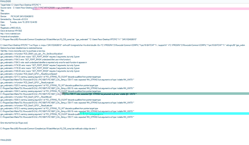

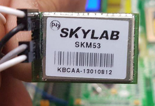

I attached photo of the gps with which I am working, I also attach capture of the error that gives me when compiling and the file that I use and that works perfectly with my previous version of flowcode. Thanks in advance
hello benj OK thanks

Re: pin TX en GPS
Many thanks for letting us know of the problem.
I have replicated the issue using your program and have now been able to fix the problem. I'll push the component fix to the updates system later on today.
