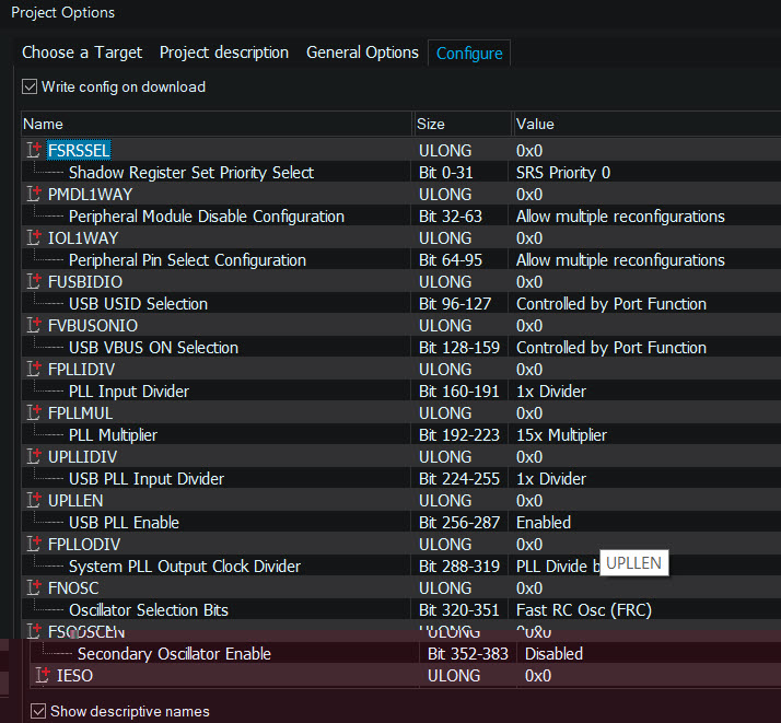

First off all you have to make sure your configuration settings are correct
(1) mcu is running
(2) running at the correct speed
Secondly as the PIC32 PWM makes amatch between the Duty set value and the value the Timer PR register is loaded with I would use the
setDuty10 parameter ,I have done this in your Flowchart and you will see the PWM in the simulation is active
Hope this helps check your configbits they look abit strange to me
(1) mcu is running

Yes, checking the configuration of this project is totally wrong.
the settings that I usually use are as follows.
The program now works correctly but only on channel 1.
If I try to change channels, the pwm will not work
Thanks for the reply.
