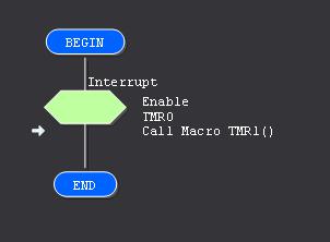

It seems no timers work at all when configured in Flowcode for PIC18F25Q10. I've tried Timer 0, Timer 1 and Timer 2 with the same results.
There is nothing else in the code, just enabling any Timer causes the code not to compile. All other code on my program works fine at the moment.

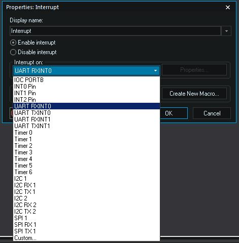

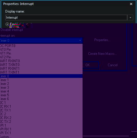

It's strange as this chip has got a total of 7 timers and not all of them are shown on the "Interrupt on" Flowcode list
  • Three 8-Bit Timers (TMR2/4/6) with Hardware Limit Timer (HLT)
    Four 16-Bit Timers (TMR0/1/3/5)

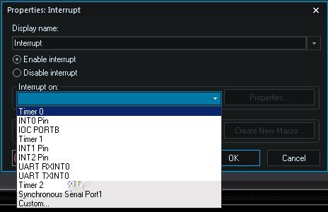

Seems the entries on the list are still a bit messed up... there are some duplicates there:

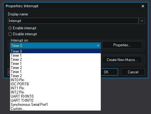

Thanks Ben, great stuff. I've updated Flowcode now (full detabse) and restarted.
The list for PIC18F25Q10 looks good now (thanks):

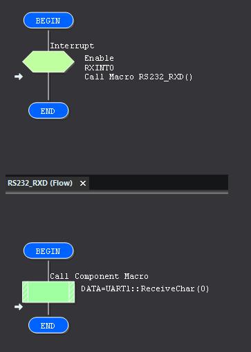

Interesting that I am just now trying some RS485 interrupt routine on PIC18F27K42 (the peer to the Q10 master I'm using) and I get a similar error:
This was whilst enabling UART interrupt on receive... with minimum code, just a timer and the RS232 ReceiveByte function...

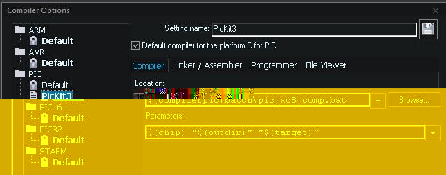

I had tried last week the latest XC8 compiler I downloaded last week as from a previous thread of yours you mentioned this could be the issue... but with same results... so reverted to the FC8 one:
C:\Program Files (x86)\Microchip\xc8\v2.05\bin>xc8
C:\Program Files (x86)\Microchip\xc8\v2.05\pic\bin\picc
Microchip MPLAB XC8 C Compiler V2.05
Build date: Dec 20 2018
Part Support Version: 2.05
Copyright (C) 2018 Microchip Technology Inc.
(880) invalid number of parameters. Use "XC8 --HELP" for help
(908) exit status = 1
Regards!
