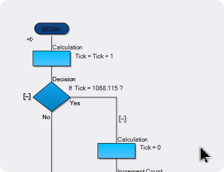

Hello everyone
Does anyone here help with getting SolarTracker to track every 5 minutes?
Have tried very much but without success ;-)
Hope much you will come up with a proposal and like where it goes wrong!
Interrup Tracking.JPG (45.67 KiB) Viewed 28883 times

One problem is here:
tick is a byte variable and can only have (integer) values of 0..255. It can NEVER equal 1068.115 so tracking period is never updated..... If tick=60 ?
The timing routines need changing (but don't change Tick to a float !)

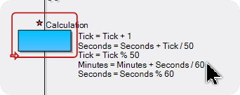

As your interrupt routine runs at 50Hz something like
as the interrupt routine would increment seconds and minutes (and could be extended to hours etc)
(Note that I've used some modulo arithmetic to avoid the 'if ticks = 50 then secs = secs + 1'... for coding speed - the 'ifs' would probably be slightly more efficient in practice)
Then check if minutes % 5 = 0 and run code whilst it does? (runs whilst minutes ends with 0 and 5 (and not for endings of 1,2,3,4,6,7,8,9))
Note that you may need to extend this to hours etc (ie Hours = Hours + Minutes / 60, Minutes = Minutes % 60)..

If you want minutes to go 0..4 repeatedly.
Then have minutes=(minutes+(seconds / 60))%5
In the interrupt handler.
Seconds go 0..59 and you need this to time the minutes run time
