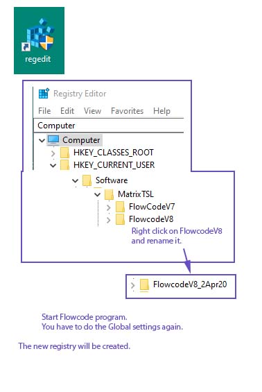

viktor_au
- Posts: 367
- Location: South Australia
- Has thanked: 45 times
- Been thanked: 63 times
Re: Flowcode 8 crash
I had the same problem on 2nd April 2020.
Finally I understood that the problem is in the corrupted registry.
After I renamed the registry the FC8 has created a new one
and I have never had any problems.
- RegistryProblemFixed-1.jpg (41.76 KiB) Viewed 18484 times
THX Victor,
I will check your solution.
I had the Problem already twice.
I deleted the Reg Key after the first case and installed FC8 again. This was running until yeserday.
Then i deleted yesterday only the Reg Key...
...until now FC8 is running again and there is a new Reg Key again.
As far as I remember the crash happend shortly I was playing with F2 and F3 Zoom Funktion.
Then I selected a decision Icon.....
BR
BR
Dirk

Thanks for the info. Can you please ensure you're using the latest version of v8 (v8.2.2.15).
- (33.67 KiB) Downloaded 1041 times

Hi maharadga,
Steve's post from here
Ben's post can be found just above it.
Steve is referring to the main Flowcode download URLSteve wrote:I think that link for the patch just takes v8.0.x and v8.1.x versions to v8.2.0. This update is essentially a service pack.
To upgrade from v8.2.1 to v8.2.2 you will need the hotfix that is available via the second link in Ben's post.

Hello together,
I´m running now FC8 in Version 8.2.2.15 over 10 days and the Problem with the crash did not came back.
May it looks that the problem is fixed.
BR
Dirk
