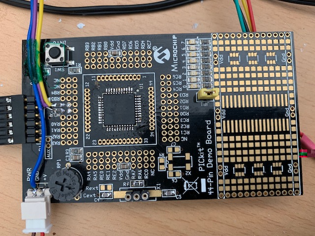

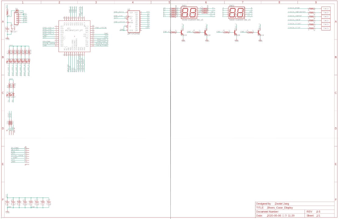

Re: PIC18F47Q10 ADC not working
I tested Microchip's 02-01924's MCU with 18F47Q10 and then tested it for sure. But it doesn't work.
Thank you.
Thank you.
- IMG_3387.jpg (149.54 KiB) Viewed 25294 times
- K-001.jpg (60.31 KiB) Viewed 25294 times
