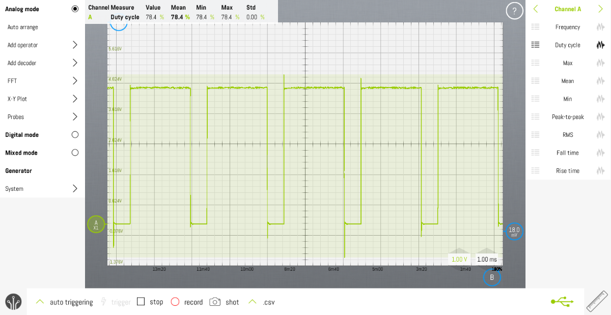

This might be me - PWM doesn't seem to work on Arduino (I tested Nano)
Using Channel 6 (Pin D3) - PWM::Enable() and PWM::SetdutyCycle(200) - just gives no output on pin.
Using Arduino IDE and pinMode(3, OUTPUT); analogWrite(3, 200); - gives a very nice square wave with 78.4% duty cycle as expected..
Am I doing something wrong - I tried various PWM channels / combinations of speeds.
How it should look:
Arduino PWM
