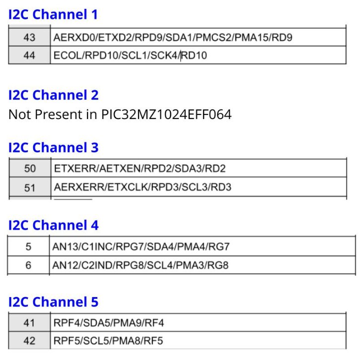

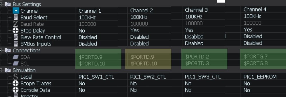

Seems a small FC I2C Component defintion bug. In Flowcode for this MCU, there are 4 channels defined: 1, 2, 3 and 4.
> However... although this MCU (64 pin version) has got 4x I2C channels, which is correct, the MCU pinout for I2C channel 2 is not present on this chip.
> This MCU has got in fact Channels 1, 3, 4 and 5 active.
> I've included an extract of the Data Sheet Showing all channel pinouts.
> I've also included a screenshot of Flowcode's I2C channel definitions for reference.
Could you be so kind as to fix the I2C Clowcode Component definitions?

Thanks for letting us know. I have hopefully now fixed the problem and pushed the change to the update system.
