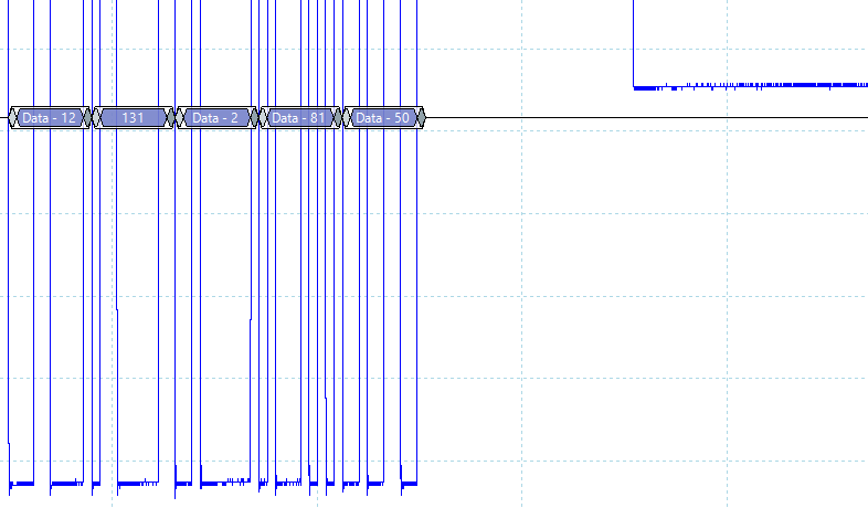

I tried it but it is not a CRC fail, the slave will answer a default replay as it seems from the scope.
It doesn't matter what i set the answer will always be the same(see attachments), even if i remove everything and only initialise the slave.
I wonder if you can take a look at this and tell me what the problem is because i can't see it.
anwser slave.png (28.11 KiB) Viewed 3208 times

Hello Mike
I changed a bit your Slave12 and run it with FC8 run Master (not on PIC, bur Arduino).
All works OK on Arduino.
Please check you PIC hardware connections and settings.
