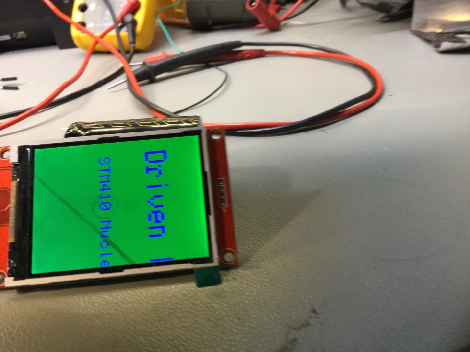

Yes, now I can program the chip again, but now there is something wrong with the orientation. If I set it for one or more, some strange sign/tekst.

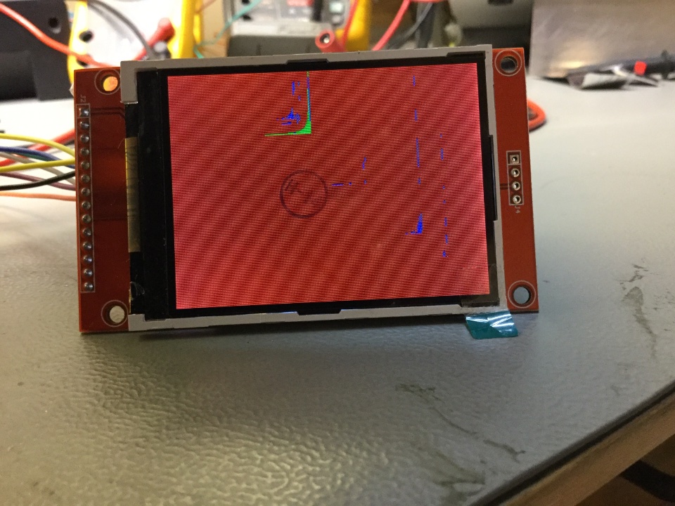

    Please, disaster disaster. First I start on a project, it seem to work, then came an update for my device, then is it not possible to program my device :(
    After loooong time battle and I inform the bug a new update come, then I use the corrected file and is again able to program again :D But now my display behavior strange. Again after looong time battle and troubleshooting I see that a new bug is coming after an update of this too :( If I I use orientation 1 or higher, see picture above.

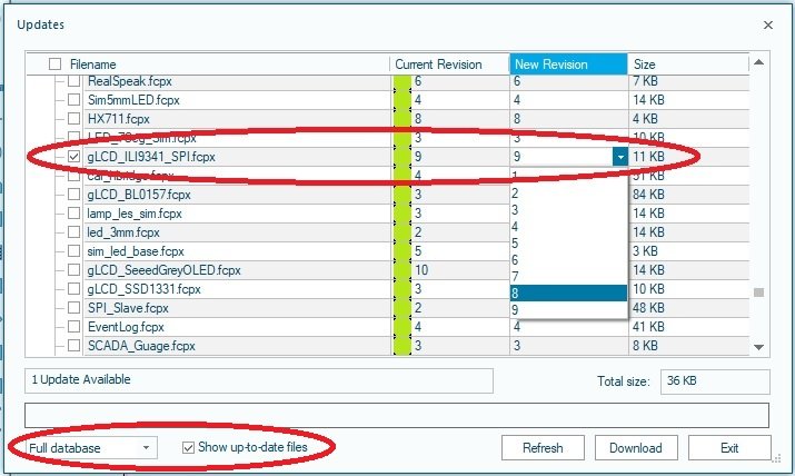

    Thank´s for reply. I already have done your suggest, but then, When I discover that the orientaion not working after last last update of Ili9341 component:
    Then I try to go back in version. After that the display not work at all, well then I try an update again and there was of course update available, run this, but it still not work at all.
    So, the hard knife :lol: uninstall FC8 and reinstall again, help, update, but the display still not work after programming :(

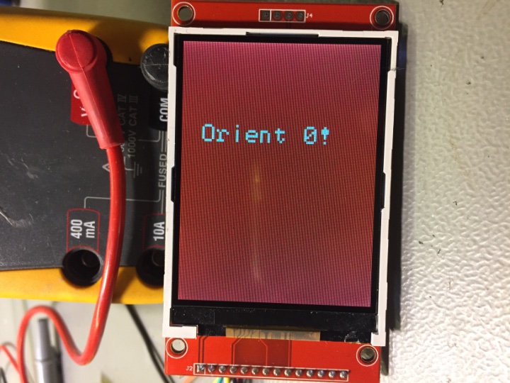

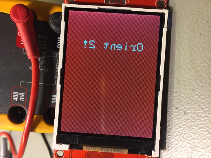

    Orient0: Seem to be ok!

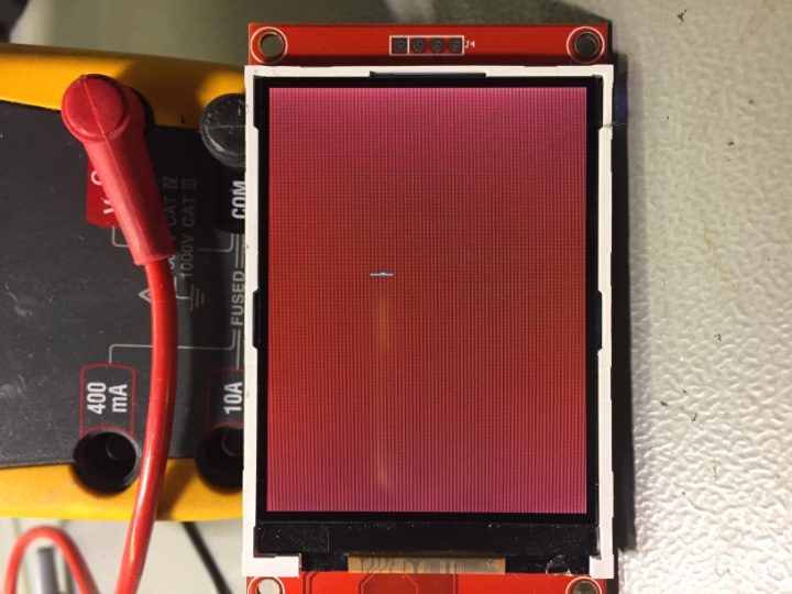

    Orient 1 Not ok. Deleting is also not working when use orient 1

    Post by jgu1 »
    Orient 2 look like mirror looking in mirror :lol:

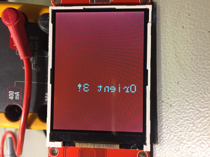

    Post by jgu1 »
    Orient 3 also like mirror.
    As you see, something wrong. Hope it help and make sense. And again this occour after last update of this display. Earlyer it was ok.
