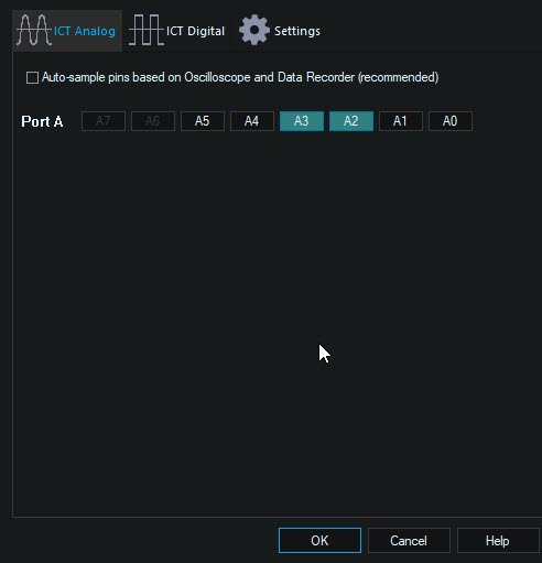

Here you can see pins RA2 and RA 3 are set as Analog pins in Ghost this is done automatically by FC
Gosht Select.jpg (15.37 KiB) Viewed 1869 times

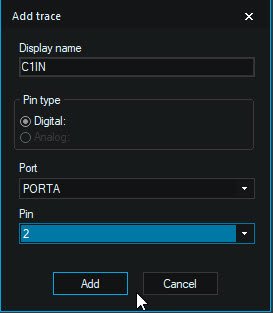

Trying to select the RA2 or RA3 as Analog pin in the recorder is not possible the Analog pin selection is always grayed out

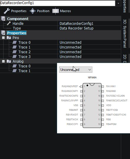

Trying to add a Data recorder Component to the 2D panel and select the pins in the property window all pins not available for selection.

Here's a definition file that should solve the problem for A2 and A3. As there is no ADC peripheral on the device we haven't enabled it for any of the pins.
16F648A.fcdx
(14.06 KiB) Downloaded 157 times
Needs to be copied here.
C:\ProgramData\MatrixTSL\FlowcodeV8\FCD\PIC
I won't do an official release for this one as it might throw a user who wants ADC functionality.
