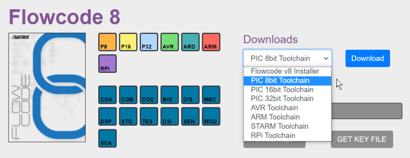

If you log in here with your Matrix account details (note: this is not this forum login, but is the same login as the v9 forum), you can access the toolchain downloads:
https://www.flowcode.co.uk/accounts/login/
For the MIAC, you will need the PIC 8bit Toolchain:
franky1978
Posts: 23
Joined: Thu Jun 13, 2019 2:29 pm
Re: MIAC 8BIT
Post by franky1978 »
i have solved thanks!
