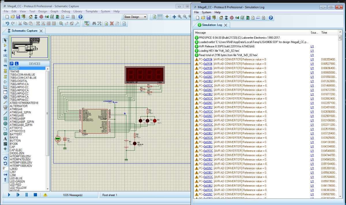

The file you ATTACHMENTS does not work properly and gives the following error in the simulation:

Sorry, It was a typo.
Can you try the attached and see if it works?
AVR_CAL_ADC.c
(26.77 KiB) Downloaded 320 times

Thank you for your guidance.
This file worked perfectly.
