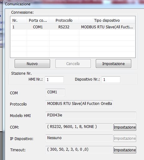

yes I use PI studio, as you see in the image the display is slave therefore I use the modbus master on arduino...

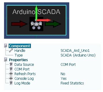

A few words about SCADA.
Note: I hope the more advanced users will add more info and correct me...
If you have bought SCADA component for FC8, you will see, that after starting a new project as SCADA, FC8 will load the Ard SCADA component.
What happens next?
You create the Flowcode SCADA program, and then export it as a Matrix SCADA runtime application (software program) to be run on Win PC.
Next: you can run this software on PC and control PLC (say, modbus slaves).
FC8 SCADA allow you:
- add some knob, fans/pumps, graph plotter, etc.
You can build the GUI the way you like.
I hope the Matrix stuff will correct me, but PC with SCADA software acts as the Modbus Master.
xxxxxxxxxxxxxxxxxxxxxxxxxxxxxxxxxxxxxxxxxxxxxxxxxxxxxxxxxx
WLC Systems example

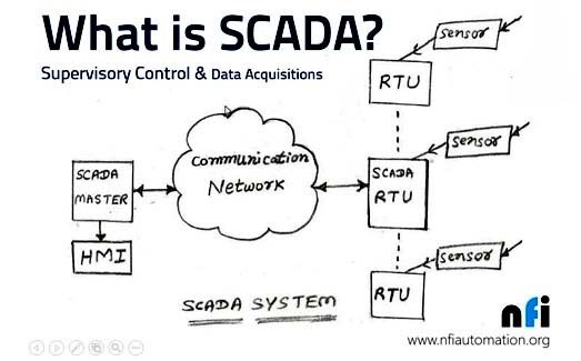

Modbus SCADA is a software for data collection and system monitoring. The software collects data from Modbus enabled systems (e.g. PLCs, Instruments, I/O Modules configured as Modbus slave devices) and displays it in a friendly way on HMI - Human Machine Interface. Modbus SCADA can be easily integrated with many data acquisition modules and also offers logging historical data. It is cost-effective and, due its simplicity, especially designed for low-volume projects.
Diagrams attached
