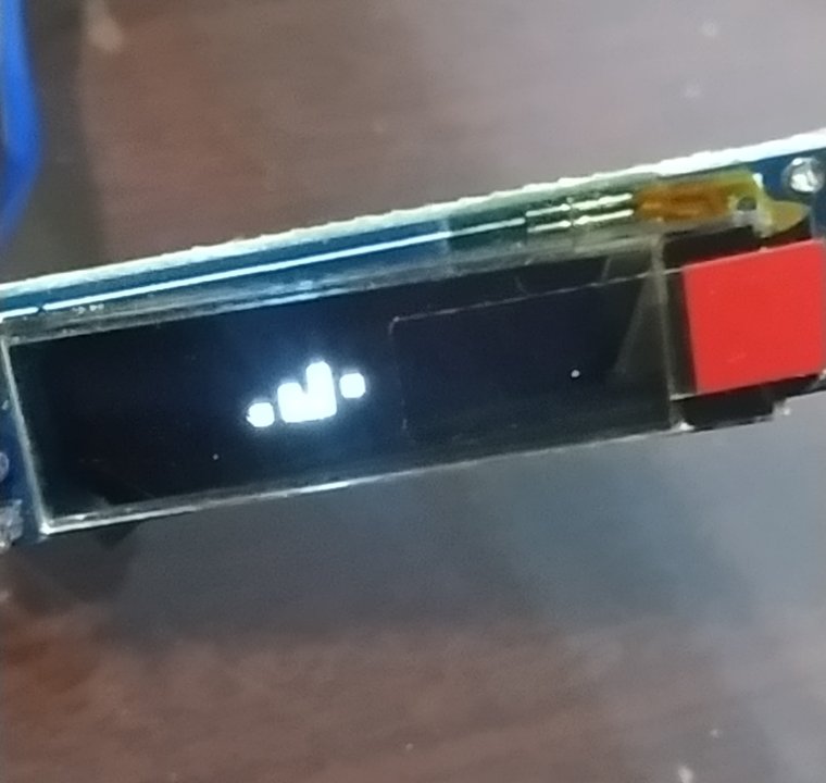

Hi everyone. I have a 128x32 glcd_ssd1306_i2c and an Arduino Nano and I couldn't get any numbers to show on it. All that shows are symbols only.

Can you please give more information?
Did you try a second, third OLED?
Do they all work the same?
Does Nano work OK with 1 second B5 flash?

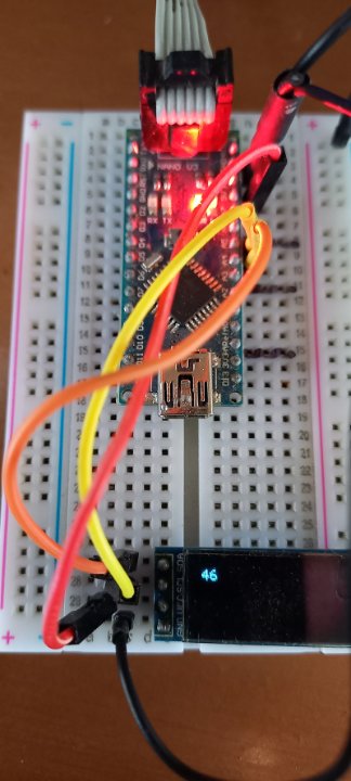

I moved to Flowcode version 6 and the same lcd and nano board work perfectly.

I used the FC8.
Works OK, only one problem with 'interlaced' function.
Didn't work in 'yes' version.
No problems with 100kHz or 400kHz
I used the FC8.
