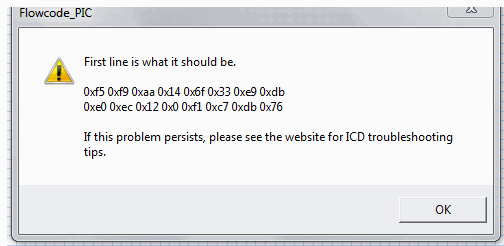

ICD Mode
Hello Benj
I have select in the projekt options the ICD mode.If i want simulate in singl steep, i show a error.
What can i do?
Programming with the pickitt2 works fine,but can i desable programming the eeprom?
Regards Wolfgang
What can i do?
Regards Wolfgang

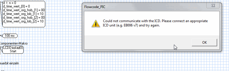

Hello
Eb006v7 wanted today in operation,without success ...
I couldn't program pic16f88.(see screenschot)
PSU = 12v-13.5v , The Board is at the factory settings.
Pleas for help
regards Wolfgang
Pleas for help
regards Wolfgang

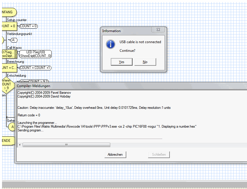

Hallo
I want install the pppv3 again and show:
- Capture 4.gif (36.12 KiB) Viewed 14330 times

Re: ICD Mode
You cannot "pre-install" these drivers in Windows 7. Instead, you need to put the Flowcode (or "ELSAM") CD in the drive when the "New Hardware Wizard" appears and then follow the on-screen instructions.
If this wizard fails to launch when you connect the hardware, you should find it in "Device Manager" and select the "reinstall driver" option.

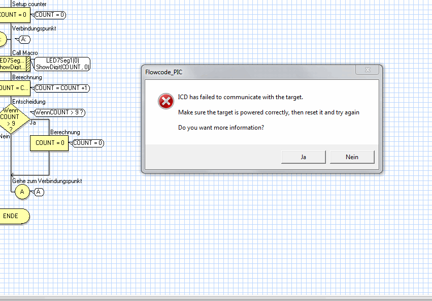

Re: ICD Mode
Hello
After new install v4 and ppp3 i dont no why,but i can program the includet pic 16f88 without low voltage and run it.
But if i want start icd i become the fellow screen`s:
I fount out:
If i have select icd and i start "compile to chip",i can program bat the chip does not start the e.g. sa led blink.
after unmark icd ,program again, it run`s ok.
regards Wolfgang
I fount out:
regards Wolfgang

Re: ICD Mode
Hello Wolfgang
Please refer to this getting started guide for help getting up and running with the ICD.
http://www.matrixmultimedia.com/softwar ... _Guide.pdf
Note that there is a small problem if you are using the internal oscillator which will cause the ICD to fail.

I can also see that your clock speed setting in the project options page is wrong.
What you need to do first is to get a simple LED flasher working at the correct rate with ICD mode OFF. This will give you confidence that the clock speed settings are appropriate for you.

I use a new EB006 V7 card, on which I have just replaced the PIC16F88 by a PIC18F4455. The crystal is the original piece (19,66MHz), the selector is on XTAL.
With the ICD mode off, the rate of the flash seems correct (approximately 0,5Hz).
