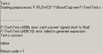

I tried a test with this program:
It simulates but it won't compile, giving this error:
Searching the forum didn't clarified this. What went wrong?

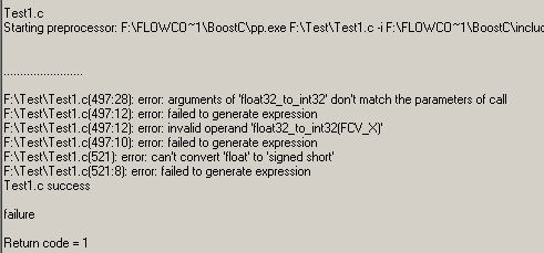

Not really, I still have errors.
Can you please verify or complete this test program so that this program works?

Good idea, because float32_from_int32 also gives similar errors.

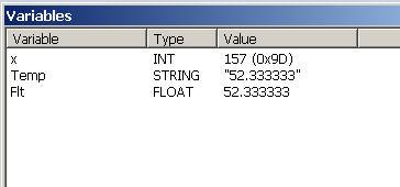

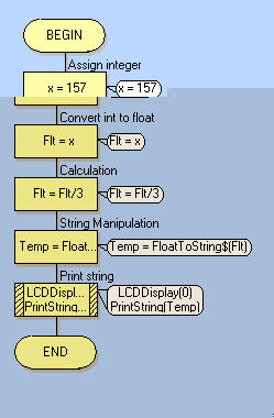

Re: Int to Float
Hello Eric
Here is a working version of your program.
Test1.fcf
(5 KiB) Downloaded 355 times

Thx Ben, now I see.
But the compiled program is hugh !
7.5K !
Floating point seems to consume a lot of resources.
