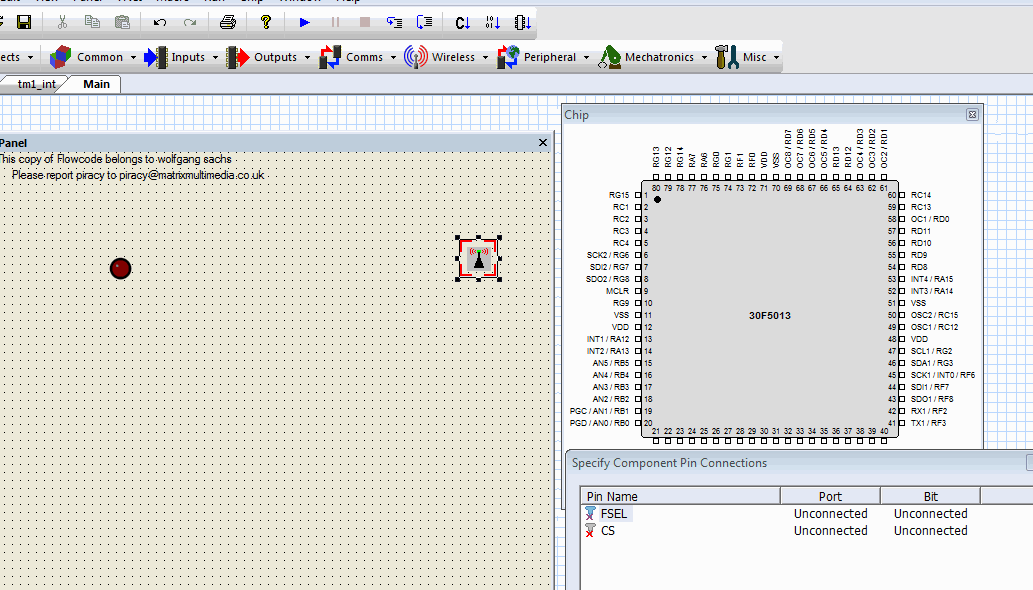

In the ext properti.. thera are software and hardware connection.
in software-conn. i can set all io-pins to ports i want.
in hardware-conn. i can set only the cs-pin and the fsel-pin to all ports.
Question:
Use the rf-macro the sck2,sdi2,sdo2 pins ? >> 30F5013
because many chip`s have also sck1,sdi1,sdo1 pins.>>30F6012A
Regards Wolfgang
EB-063 connection RF-macro

Hi Wolfgang,
When the component is in hardware mode it will default to SPI peripheral number 1.
E.g. sck1,sdi1,sdo1 pins
You can re-assign the SPI peripheral if you wish by using the custom code feature to change the following definition.
#define MX_RF_SPI_HW %a //SPI Hardware or Bitbanged Port Control
to
#define MX_RF_SPI_HW 2 //SPI Hardware Peripheral 2
to

Hello Benj
I have understand your answer and i now the costum-code-macro
but i have a big problem to use it in praxis
is there a example for rename the 3 spi1 pins to spi2 because i use the int0 (is the sck1-pin)?
regards Wolfgang
regards Wolfgang
Re: EB-063 connection RF-macro
Hello Wolfgang,
Yes as I seaid before switching between peripherals is fairly straightforward.
Select the RF component on the panel and click the custom code button in the panel properties pane.
Then select the defines function and click edit.
Find the line near the top of the defines.
and change it to match this.
Click Ok and hopefully that's job done.
