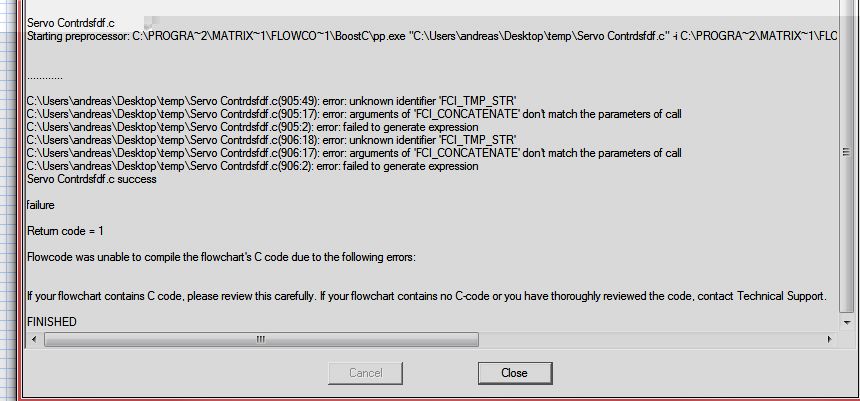

Re: Controlling a Servomotor with timer0 interrupt.
I am trying to open your routine and I have an error!
I have attached.
Does anyone has a clue?
Thank you
Andreas Achilleos
I have attached.
Thank you
Andreas Achilleos
- (42.89 KiB) Downloaded 33928 times
I am trying to compile the first fcf file Servo Controller1 FC3 16F88.fcf and I get an error!
Funny thing, I tried that yesterday on my other PC and first ( due to the fact that I had messed a little bit with it!) I had the same error:''if your flowchart contais C code'', but after I downloaded it again and it was OK!
Now I keep getting the error and I have not altered the file.
Do you thing that PC configuration or folder location can cause these errors?
Martin, in your flowchart you state internal clock of the 16F88, so I must put the switch on the EB006 to the '' RC '' intead of '' XTAL '' ?
I didn't had the chance yesterday to test your routine when it was succesfully loaded into PIC due to trhe fact I do not have an ADC board!
Can your routine work with keypad instead?
Thank you.
Thank you.
- error.jpg (64.31 KiB) Viewed 69606 times
Hi Andreas,
The following warnings about ADC will be ignored etc, are there because a Flowchart created with Flowcode V3 is opened with Flowcode V4.
With V3 you need to sample ADC 1st then use another component to assign the value to a variable.
With V4 that's not the case. Sample part is not used, so it's simply ignored. Hence the warnings.
As for the Errors.
Common cause would be if target device is changed, and there is a component that had not reassigned.
Have you changed to a different target device?
If you would like to post the flowchart that's causing the issues, I can make sure it works on my system 1st.
As for the RC switch. On my EB006 I just moved the jumper that's next to the xtal from OSC to A6&A7 position
As for the Errors.
Hello Martin,
Thanks for the respond. The flowchart that is causing the erros is your own that I downloaded at the beginning of your post above!
As I told, on my other PC compiled just fine but in this one not, hence the questions I made if a PC configuration might be causing this.
I have not changed the target device.
Can I use that flowchart on 16F877A or 18F4550?
Thank you.
Thank you.
I was just wondering if you change target device.
But If you have not then that's odd?
Yes you can use any target device. I have successfully use a 18F4455 to drive servo, using flowchart posted.
Try this version that I have saved with with FC4
- Servo Controller 4 Channel V1 FC4 16F88.fcf
- (15.43 KiB) Downloaded 1427 times
This one compiles just fine!
Of course I do not have an ADC board so I can test it!
I will try to modify it and work with a keypad, do you think that would be easy?
I have one issue though and that might be happening because the servo board and or flowcode routine does not actually work as it should have. When I connect the power to my EB006 then the servo moves righwards, lets say. If I unplug the power and replug it then the servo moves the other way and this happens every time.
Do you get this when connecting the power?
Also where do you have the swithes on the EB006 on RC and slow?
Thank you.
Thank you.
