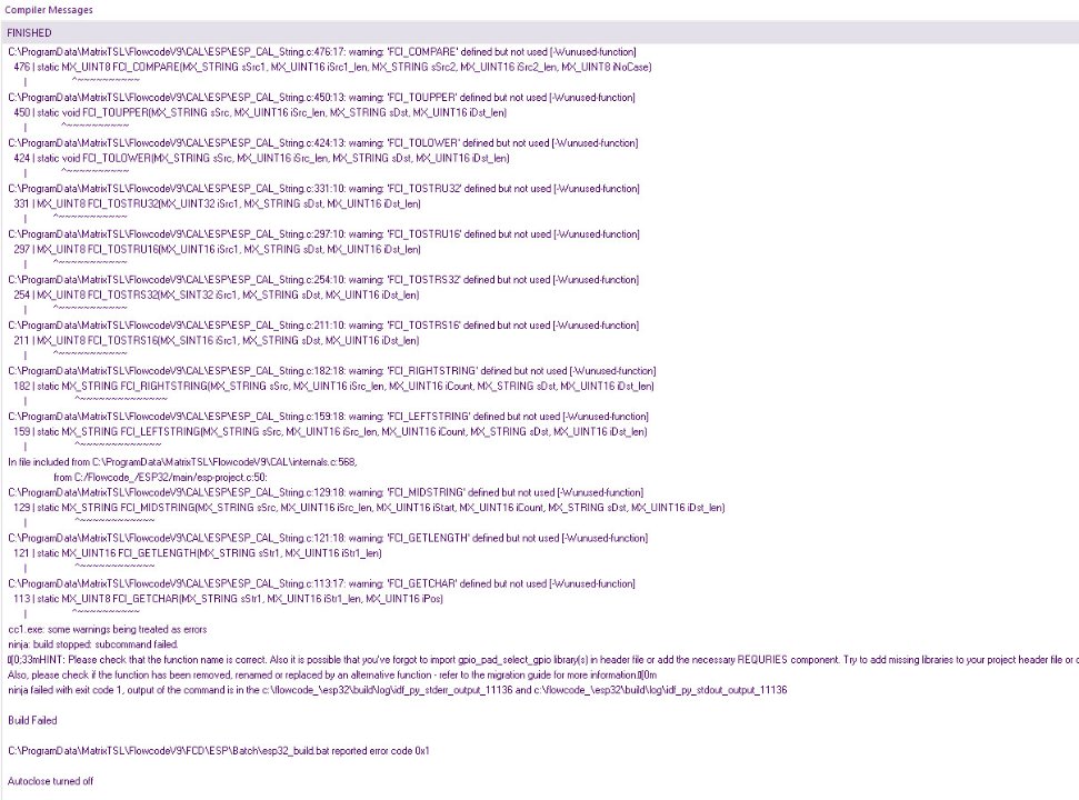

Sorry, but it does not work. You can see attachement.

Can you also post your Project name.msg.txt file
Unfortunately, screenshots like the one you posted does not help us to help you at all.
Most issues are caused by using a later-than-suggested version of ESP-IDF.
Take a look at this post.

It looks like you are using the latest ESP-IDF (5.0) which is not supported, we recommend using version 4.1 in the installation guide.
There is a way to roll back the IDF which we document here.
viewtopic.php?p=9222#p9222
We are investigating adding support for the latest version but a lot of things has changed and so needs to be done in a careful way to avoid breaking functionality.
