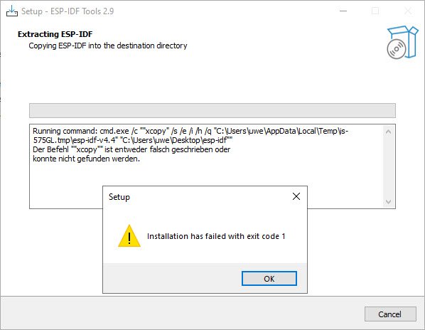

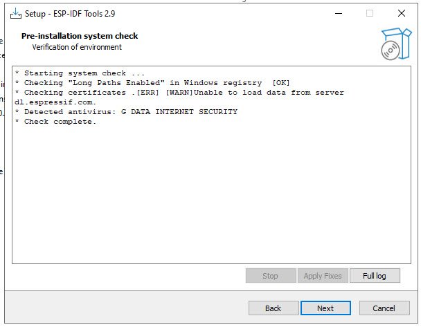

I have uninstalled FC and ESP32 and Phython and and....
reinstalled everything, deleted directories because it was not possible to uninstall them
installed different versions of Phython, ESP-IDF and Tools etc.
in different directories etc.
result: does not work.
and now new :installation is aborted by error.
I don't get it.
For the stupid, what do I have to do?
Which version to install where?
What must be installed first?
What has to be started where?
What do I have to enter where?
Do I have to restart FC in between?
Why can't I uninstall and reinstall everything...?
Couldn't such problems be solved with the TEAMviewer software?
I don't get it.

Re: Problem with the installation ESP32
Hi medelec35
The software wants to install itself here.
See pictures.
Can you tell me if it works like this or what do I have to change here?
With kind regards
SpeedPic32
See pictures.
With kind regards
SpeedPic32
