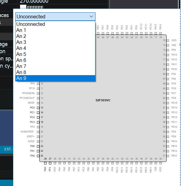

Today I have started developing the code for analog channels with STM32F303VCT6 components and I found some mismatch in ADC pins. Please help to check.
Below are the details:
As per datasheet STM32F303VCT6 MCU has 39 channel ADC. But Flowcode component has only 9 Ch ADC.
In our project, we used all the ADC AI pins in both Chip. So please help to resolve these issues. Thanks.

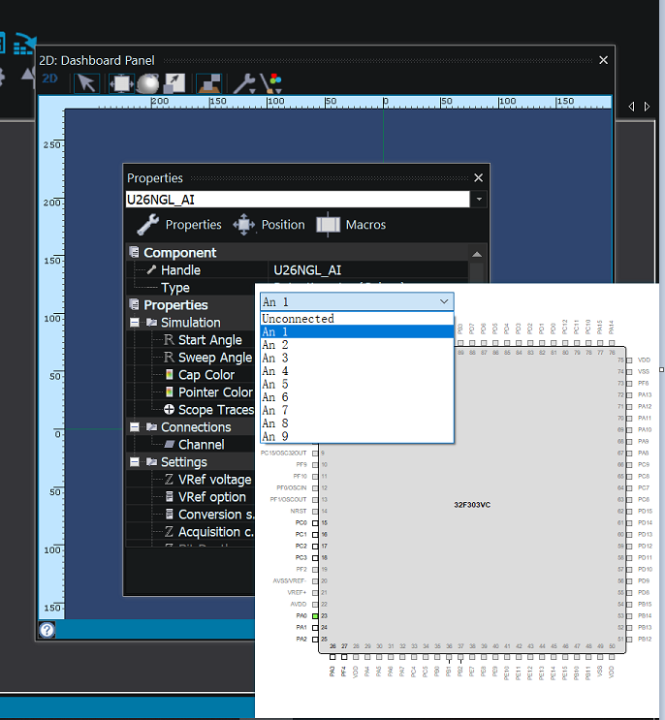

Today I have tried to develop the ADC for STM32F303VCT6 MCU and I found that, all ADC pin's are not enabled. Because STM32F303VCT6 has 39 ADC channels. but our Flowcode shows only 9 ports. Can you please help to modify the same?
https://www.st.com/resource/en/datashee ... f303cb.pdf
Karthick,

You need to download and use the files I posted earlier ...
STARM_CAL_ADC.c goes into directory C:\ProgramData\MatrixTSL\FlowcodeV8\CAL\STARM
32F303VC.fcdx goes into directory C:\ProgramData\MatrixTSL\FlowcodeV8\FCD\ARM
If you subsequently do an update these files will be marked as not genuine, untick the box to ensure they don't get over-written.
Once you have confirmed that these changes are OK for you, I will get these updated files into our auto-update system.
Hope that makes sense.

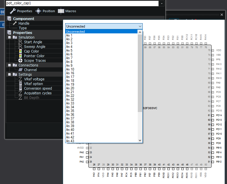

Thanks.I followed your instruction and now I can see all the ADC pin's.
Thanks.
Thanks.

Can you please help to update STARM_CAL_ADC.c files to auto update system? I have tested and it is working fine. Thanks.
