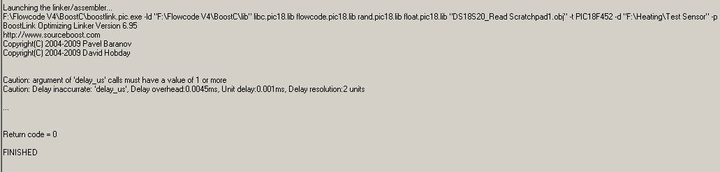

Hello Benj
I received nearly the same warning if i work with the delay component.
Regards Wolfgang

Hi Ben,
I think the problem appears the moment there are certain errormessages from the assembler/linker.
If no errormessage, you see the memory usage.
If there is an errormessage, it looks that the memory status is overwritten by the error.
