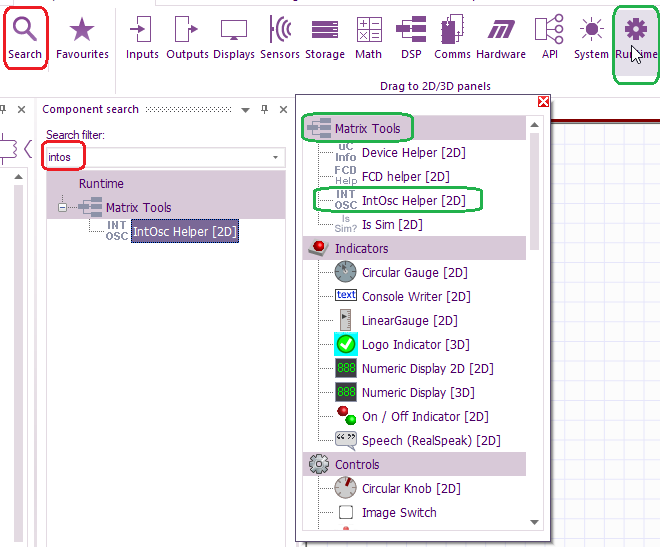

The is an '''Internal Oscillator Helper''' component which is located in '''Components Libraries''' > '''Matrix Tools''' > '''IntOsc Helper'''
Alternatively, Use the search magnifying glass option.

This can be found on left of the '''Components Libraries''' and enter '''intos''' in the search bar.
[[file:InOscHelper1.png]]

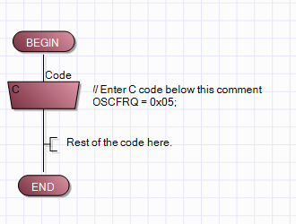

3. Enter the required speed in Hz e.g 1600000
4. Copy the full contents next to the code window (OSCFRQ = 0x05;)

5. add a C code command icon at the top of Main and paste the code that was copied in step 4

[[file:InOscHelper2.png]]
The internal osc should now be set at 16NHz, assuming all the configuration settings are correct.
