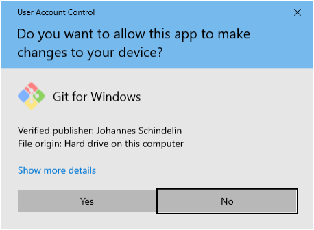

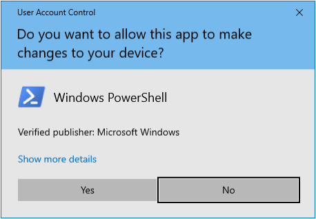

During the installation process you may get some of the following pop-ups appearing
Click Yes to allow Git to be installed
Click Yes to allow Windows PowerShell to be installed

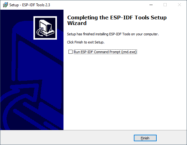

Installation complete
You do not need to run the ESP-IDF command prompt as we will be invoking this from Flowcode:
A PC reboot may be required after installation has been completed.

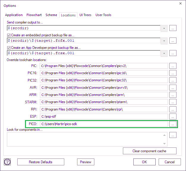

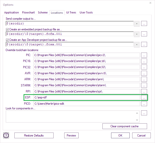

Setting up Flowcode for use with the ESP32 toolchain
Copy the location of the esp-idf (e.g. C:\esp-idf) into the
Global Settings > Locations tab.
Or if you have a project loaded
File > Global Settings > Locations tab:
Click OK

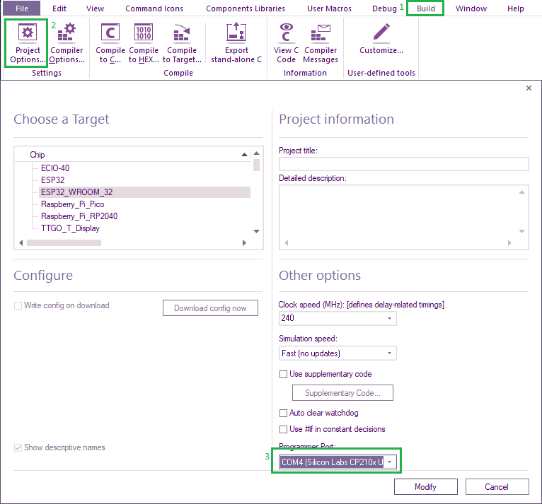

If you connect your ESP board before running Flowcode then the boards COM port will appear in the Flowcode project options.
This will need to be selected and correct for the Compile to Chip menu option to function correctly.

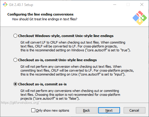

Don't select any NEW! options, leave options as default. Select "Checkout as is, commit as-is":

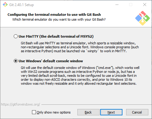

Select "Use Windows' default console window":

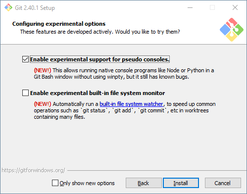

Check "Enable experimental support for pseudo consoles" during the installation process:

Setting up Flowcode for use with the Pico toolchain Copy the location of the Pico sdk (e.g. C:\Users\YourName\Downloads\pico-sdk) into the
Global Settings > Locations tab or if you have a project loaded

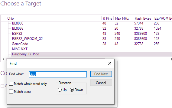

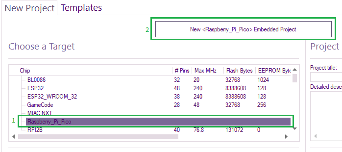

Run Flowcode & Select New Project
Either right-click on any target & select Search... and enter pico, then select Find Next:
Or Go to the Free targets section, expand Free targets and scroll down and select Raspberry_Pi_Pico
Select New <Raspberry_Pi_Pico> Embedded Project:

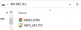

Sending Your First Program
Before sending your flowchart to the Pico, you must first enable boot mode.
To do that, make sure the pico is not connected to your PC.
Hold the BOOTSEL down and plug the Pico into your PC.
If you hear the USB connected sound and you also get a popup like this:
Then your Pico is ready to be programmed.
