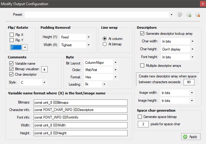

Once the software is installed, run the software and click the spanner (wrench) icon next to the Preset. Configure the software like this.
For a fixed width font like courier new you can change the Width (x) setting from Tightest to Fixed.
