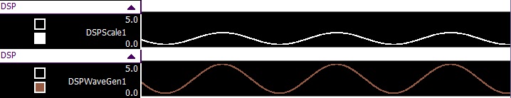

Here is an example which demonstrates variable scaling based on an analogue input.
Here are the traces as seen on the data recorder window.
The RightShift macro is a very efficient means of performing a division but only for values which are a power of 2.
The LeftShift macro is a very efficient means of performing a multiplication but only for values which are a power of 2.
LeftShift(1) = Multiply by 2 / RightShift(1) = Divide by 2
LeftShift(2) = Multiply by 4 / RightShift(2) = Divide by 4
LeftShift(3) = Multiply by 8 / RightShift(3) = Divide by 8
LeftShift(4) = Multiply by 16 / RightShift(4) = Divide by 16
