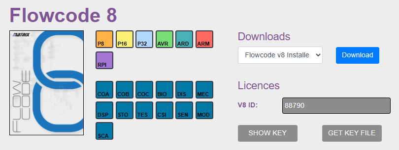

1) Access your Flowcode account via the link below to access the 3 pieces of information required for offline activation.
https://www.flowcode.co.uk/accounts
2) Scroll down to the appropriate Flowcode version to select the licence info and make a note of the Licence ID.

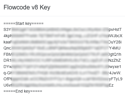

3) Click the 'Show Key' button and make a note of this Activation Key.
4) Click 'Get Key File' to download the Licence Key File.

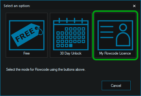

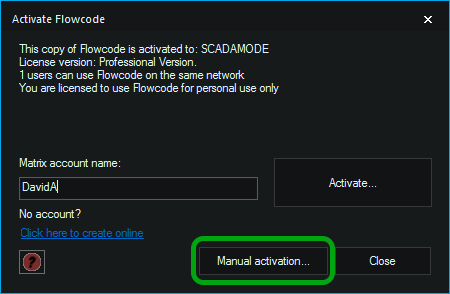

6) If using Flowcode v6, go to 'Help >> Activate', otherwise go to 'Help >> Manage licences...' and select 'My Flowcode Licence'.

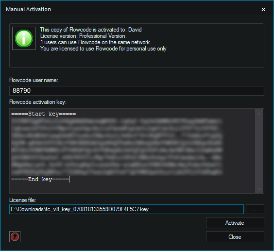

7) Select 'Manual Activation...'
8) Enter the Licence ID at the top, copy and paste the entire Activation Key (including =====Start key===== and =====End key=====) into the box provided.
9) Click the '...' button and select the 'Licence Key File' downloaded earlier.
10) Click the 'Activate' button.
The licence should be applied when you restart Flowcode.
